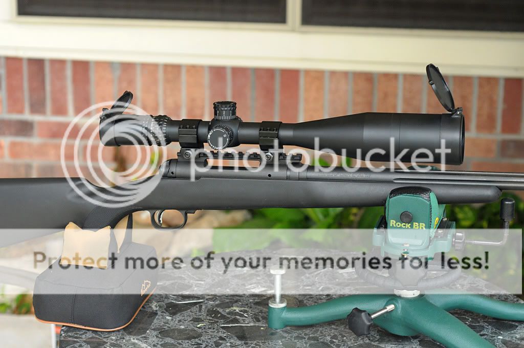

I have the NXS 8-32 NP-2DD and love it. I looked thru a 12-42Br this summer and the mirage was awful, had to lower it to 24 to get a clear pic. I usally leave mine on 24 when shooting paper but when there's no mirage will take to 32 and use the 32 to help site others targets for them. Also if you want to take it hunting being able to go to 8pwr is a plus. This scope is goin to see alot of guns under it in it's life time. This is a keeper fore sure It's built like a tank. Right now I have a $1755 scope on a $700 rifle. Next gun will be a custom 6BR.
