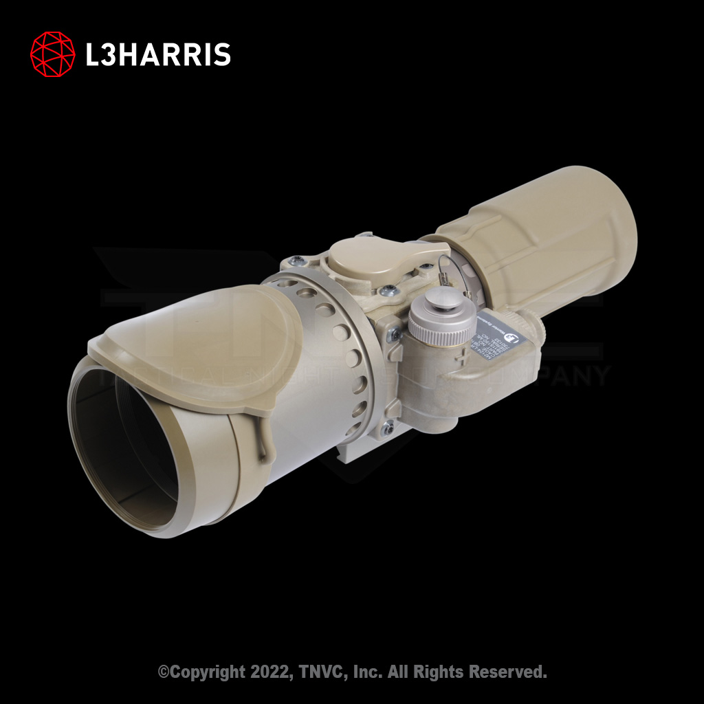

Yes there are units that mount in/on front of day scopes, usually called clip ons.
For the price of those you can have a dedicated thermal scope like the Adder, Infiray or others.

There are thermal clip ons but unless willing to drop over 18K not worth the dime. I don’t know if any Night Vision that is clip on. Night Vision requires CCD screen and IR illuminator to see image.
Clip ons I’ve played with require too much work lining up scope, adjusting focus, matching focus, lining up reticles. Using the right reticle.
You’d be better buying top end QD mounts and entry level thermal vs current clip ons. Just my experience.

Been using one of these for the last several years

I own an N-Vision HALO 50 thermal that I attach to my 6.5 Grendel when I hunt Hogs down in Florida every year and have never had an issue Identifying a target. I liked this scope so much, I ended up buying an N-Vision Atlas 50 Binoculars. I started out using a Gen 3 night vision clip-on with an Aimpoint for hogs along with an infrared light but rarely use it much any more since I picked up the 2 N-Vision 50's. The cost of the 2 was more than $4,500 less then the $18k price point you stated.
