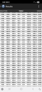

Jackie, I've attached my drop chart for mine. I'm at 5000 ft, so a bit different. I have a 35moa rail, 7x35 ATCAR, and running the 300 grain Bergers. You won't need the anything extra for easy come ups for a mile. I'll split the money I just saved ya. :)
Mine is ffp, I think if I were to do it again, I'd get the 2nd fp. The reticle in the f2 is quite a bit finer.
