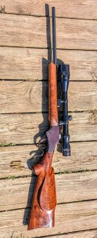

I just picked up this Wycliffe 76 rifle in 22 Hornet. The scope is an old Japanese made Tasco with ranging reticle. Now I just need to bed the forearm, and work up some loads. All that said, I can't find any load data for the 35 grain VMAX or Nosler Varmigeddon bullets with CFE BLK. Any insists with this bullet/powder combination is greatly appreciated....
Regards to all, Eric

Hodgdon has info. Velocity's are pretty low with CFE BLK but it shot very accurate in my Anschutz 1730 K-Hornet.
https://hodgdonreloading.com/rldc/
cfe-blk is a outstanding powder in the Hornet
I use it quite a bit and have found it give very good accuracy with all the bullets I use from 30-50 gr's.
good choice

That`s a beautiful rifle!!!!
Mine is a:
CZ527 22-Hornet
Burris Signature HD 3-15x44 (w/OEM CZ rings)
My Load data (load was worked up - YMMV)
Remington cases
Lil`Gun 13.0gn
Pistol primer
Barnes 30gn
Results:
Coyote`s + Head shot 150 yards = Instant Dirt Nap

I see a load of loads worked up using Pistol primers in the Hornet. Is there a benefit?
I had great accuracy with both Lil Gun and 1680 pushing the Barnes 30's out of a CZ 527.
How good was your accuracy with the Barnes 30’s?
If you crony’d them , what velocity did you get?
I have an interest in trying them in my model 43 hornet.
