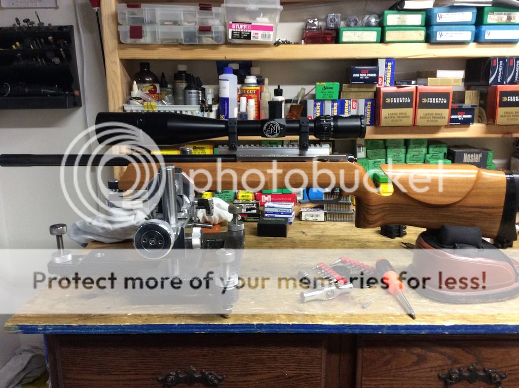

Here is my set up:
Test everything @ 50yrds, don't buy a bunch of ammo off the shelf..speed is the King, get ammo that has the speed on the box (Eley), buy 3-4 boxes @ 1050-1055, 1055-1060 up to 1080..then you can worry about lot# and machine # when you find a speed your rifle likes..as far as a Rim thickness gauge, don't bother, I have used one and I wish it did what it's suppose to.
PS: That's a very nice looking set up you have Crackerbacks!!
