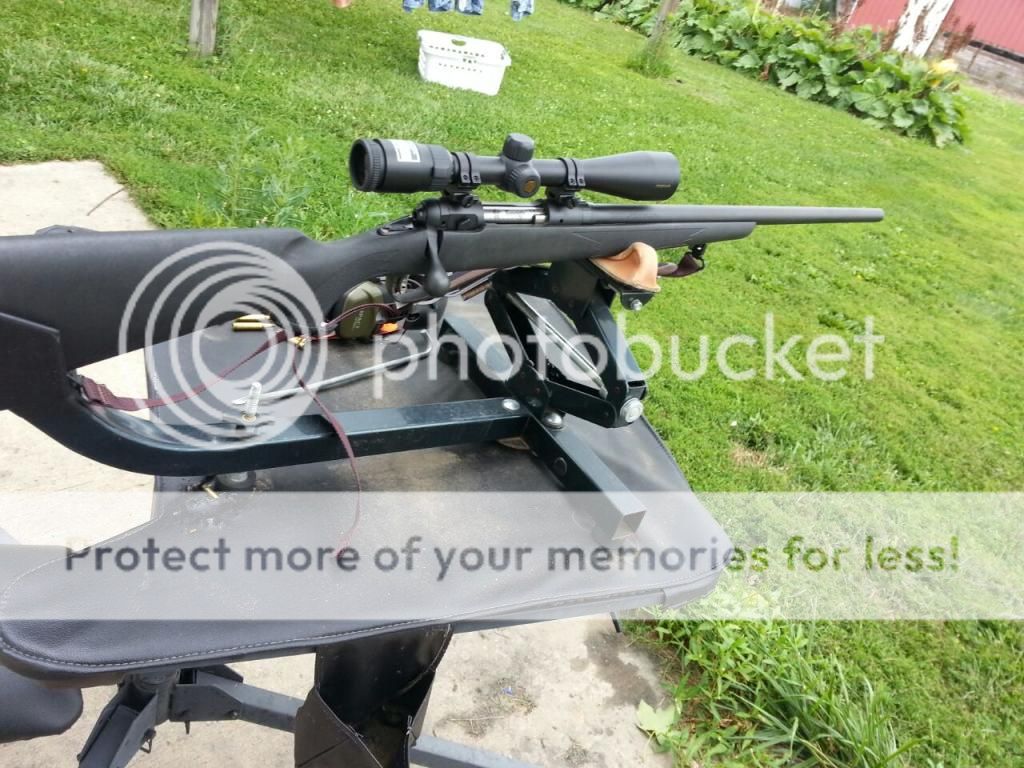

I shot off of my little rinky-dink shooting table I made and I used the Caldwell bipod and a rear bag to shoot with. Needless to say I'm very pleased with these results @ 100 yards. The first 2 groups of 25.2 and 25.4 weren't bad at all with both being about 1/2" groups but the 25.6 group really impressed me so I think this barrel is going to stay on this gun and I'll do some more testing along with some seating depth testing and see just how good this thing will shoot but it looks like it's got great potential already. ;D
Here's a pic of the rifle ..........................
