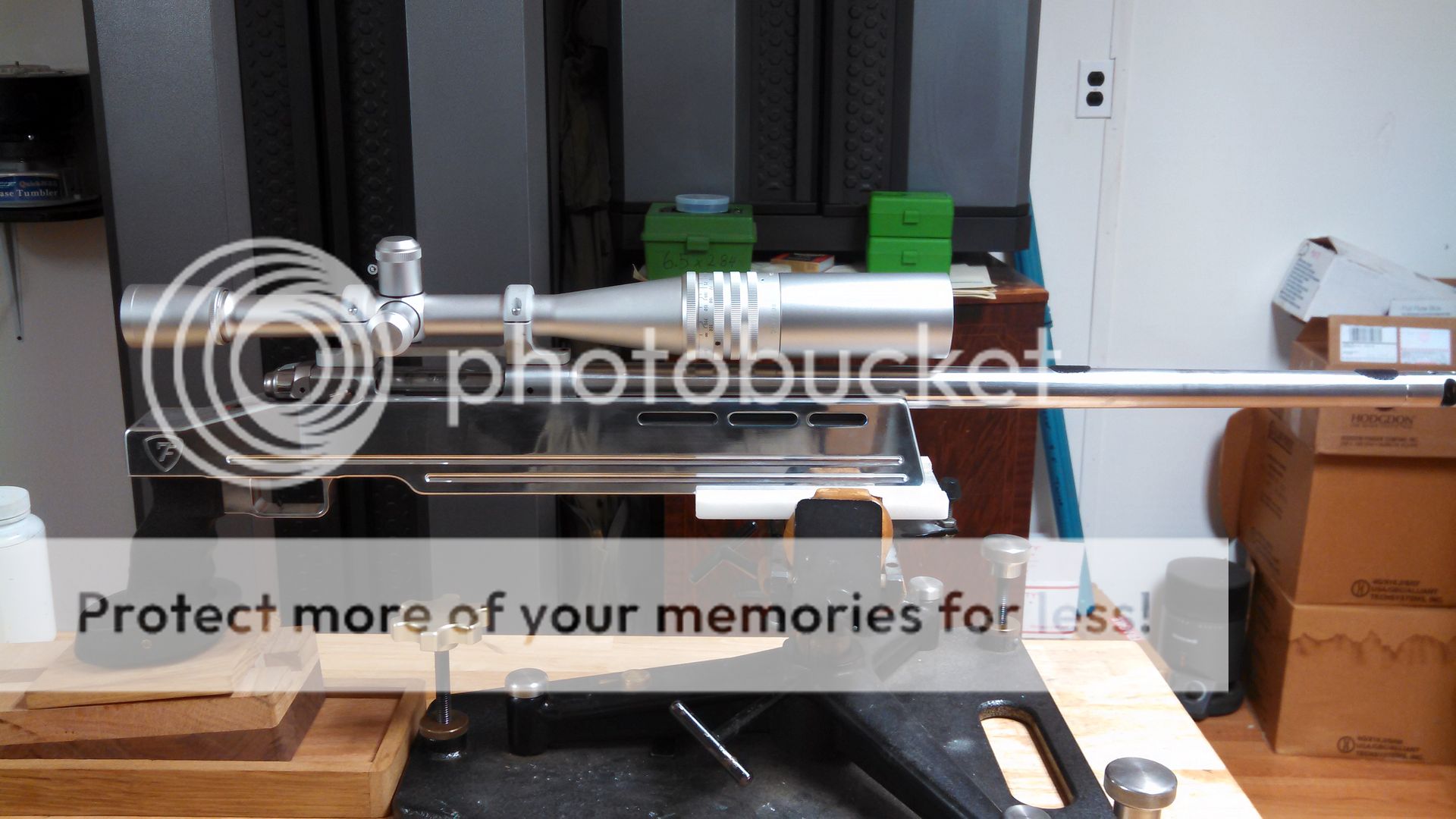

Anyhow the gun is a savage Striker with a shilen 1-13 twist x17" .269 neck chambered in a 6BR. The stock I believe is a 7Fingers and it has a Timney trigger set at 6ozs.
Here's the gun setup, I bought some delrin and used the table saw to machine a slot in it to fit the stock in so I'd have a 3" wide surface to use with my rests.
