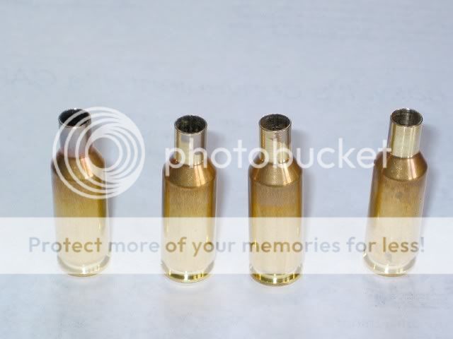

Not to get too far off-topic here, but it has been suggested that Lapua Brass needs nothing.
I would assert that even Lapua brass benefits from clean-up turning.
Here is a photo of 4 cases from the same box of Lapua brassI had recently . The cartridge on the left is unturned. The three right-hand cartridged demonstrate that with a cutter set to remove just nder 1 thou, the neck thickness is still quite variable. The case on the right was thick and even. the two middle cases show areas thinner than the depth of the cutter.
I personally believe that meticulous brass prep pays dividends.

Thank you for the pics, they make an excellent point!
While I still think Lapua brass represents an excellent mix of *overall* dimensional consistency, hardness, brass life, etc. etc. I've seen much the same thing with some of the Lapua cases that I've neck turned in the last year or so... most of my Lapua .308 is pretty consistent to begin with, but my first box of 6.5-284... was worse than that shown above. Now you got me half-skeerd to go take a closer look at my Dasher brass,un-turned used in a no-turn neck .272 chamber).
