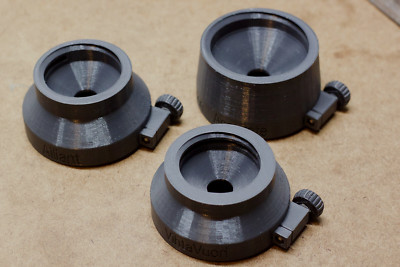

Iowa's Ted Hunter makes lots of nice 3D printed reloading accessories and recently started offering these bottle adapters for the Redding measures. The two I have work with the Hodgden/IMR/Accurate/Winchester and the V.V. bottles. They feature a 1/2" diameter baffle opening and the texture promotes a nice flow of the granules. Here's a few pics with how they fit my well used, slightly worked over Redding 3BR.

Ted's adapters.

I spent a good amount of time putting some different powders through it. The design of the adapter definitely helped the weight consistency of the thrown charges.

Where have these been my life? Just ordered 2. Merry CHRISTmas to Al and all.
I got a MEC which is no brainer if you have a lot of their bottles and got VV because that's what I use the most of. Fit on the Redding measure and the bottles is perfect.
