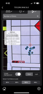

Part of the reason I wanted to start this discussion (maybe should've mentioned this in my original post..) was to share some of my findings from an app I've been working on. At its core it's a group analysis program that does a bunch of statistical calculations, and one of the outputs (alongside Mean Radius, CEP, etc.) is the Zero Uncertainty circle. Basically, it answers the question: how far from the group's center is the true zero likely to be, at some confidence level (say, 95%)?
This is calculated by treating a group as a normally distributed set of points in two dimensions, and using some standard statistical methods (in this case, the Hotelling's T^2 statistic scaled with an F-distribution) to calculate the confidence interval for the population mean, aka the circle that is likely to contain the true center of the system's "cone of fire".
A "typical" .77 MOA 5-shot group has a 95% zero radius of .54 MOA - i.e. the true zero is likely somewhere within .54 MOA of the group center. With a 10 shot, 0.83 MOA group (similar precision as the 5-shot group), the zero uncertainty radius shrinks down to 0.24 MOA.
I've included a screenshot from the app to show what it looks like (the white circle around the center is the zero uncertainty circle).
Of course, the application for the rifle dictates how much this matters. Being off by 0.24 MOA is likely totally acceptable for the majority of use cases, outside of maybe ELR shooting, and for many applications 2 or 3 shots are likely more than enough. But I figured folks here would find this interesting.
Finally, I'd like to gauge interest from the seasoned shooters here on a feature like this. Would you find a "Zero Uncertainty" output to be useful when you're doing group analysis or trying to characterize your system's accuracy/precision?

Haha, I certainly don't want to come off as preachy about statistics or anything, and I'm not trying to market my app (it's not available to download yet). I've found this forum to be friendlier in general than some of the other places, and it's great to learn about how people do things that's different from how I do them.

If you shoot a 100 shot group, and randomly select 10, 10 shot or 20, 5 shot groups.
How many “true zeros” would your app show?
How many of those would be the same as the 100 shot “true zero”?
How far off would they be?
