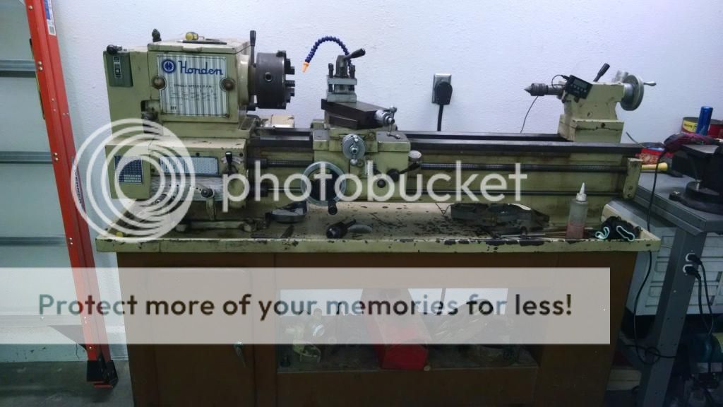

So after taking some advice from all you knowledgeable guys i waited to find a used lathe locally instead of buying a new lathe. So here it is

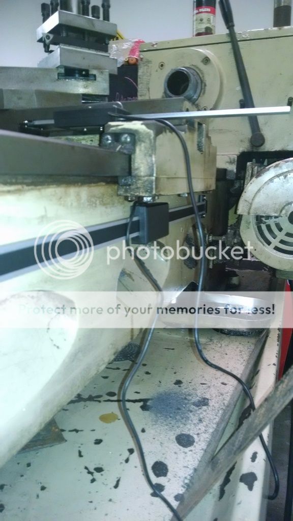

Older early 80's taiwan 12x36 with 1.5" MT5 spindle bore. It has everything im looking for in a home hobbiest lathe. I ordered a quick change tool post and am working on a coolant pump this weekend. Also I installed some Cheap DRO on it just for a quick reference. I figured the DRO isnt going to be used for any barrel work just rough cuts to get close then mic everything once im close.

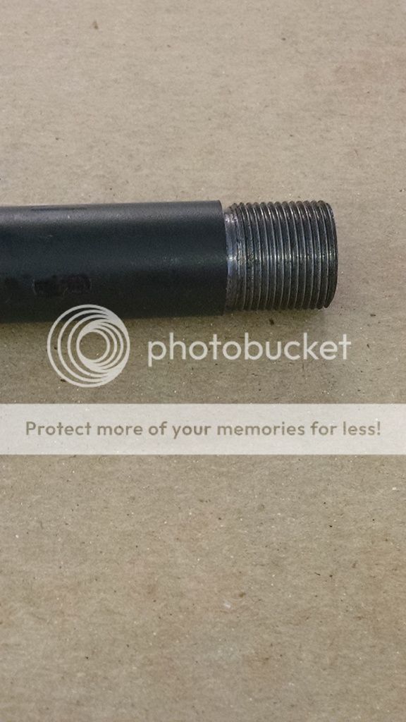

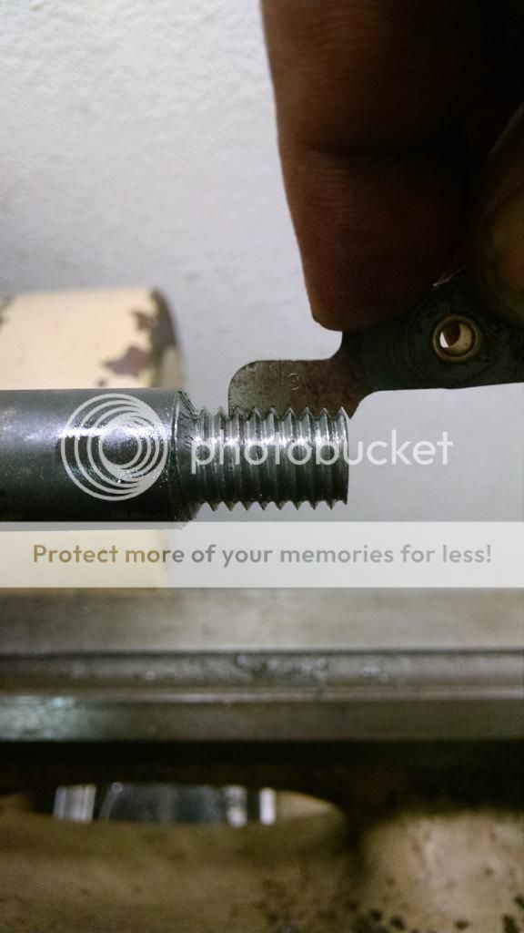

These are the first threads I cut on it last night, i was using a cheap carbide insert so the finish is not great but they are 1/2-13tpi
Everything seems to work pretty good and smooth on the lathe, a hell of alot better then the first lathe i had.
.300WBYMAG said:
It was a stub of a barrel i had, cheap remington SPS finish.
Well, not much better than cold rolled then, LOL :)
How much barrel did you have hanging out past the chuck? Anything more and twice the diameter, you want to support with a center.
Keep your tooling sharp and practice away.
That looks almost identical to a Taiwan built Jet BDB 13x40 that I have been using for the last 25 years. The only difference I can see is the Paint color and the tailstock handwheel.

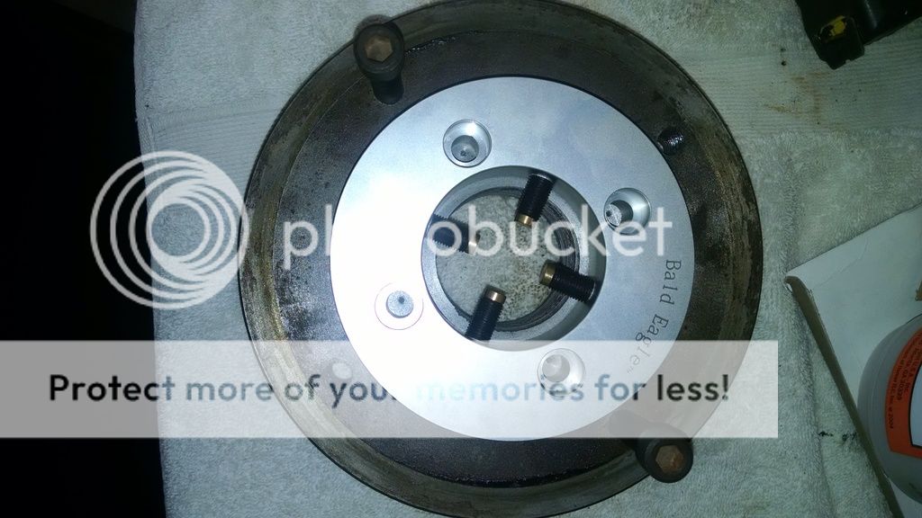

I looked as much as i could to find out more about the lathe. Pretty sure its a generic Taiwan lathe sold to a bunch of different companys IE Jet, Grizzly, Enco and others. The only thing i wish that was different is that it had a D1-4 spindle mount becuase its threaded 2-14/" 8TPI but i got it at a really good price so just bought it.

http://grizzly.com/products/36-Remote-Digital-Readout/T26628
http://grizzly.com/products/12-Remote-Digital-Readout/T26626
Cheap I gaging DRO from grizzly, after working with it a couple days the only issue i see is the DRO is not very fast with the read out. I stop before i get to zero and finish the cut manually. It fairly accurate im learning to just sneek up on my cuts and check with a mic for final diameter.
I also made metal covers that go over them but i havent taken any pictures of them yet. I have talked with other people using them and they told me that oil or cutting fluid on the scale with give false readings so i try to keep them covered as best i can.
