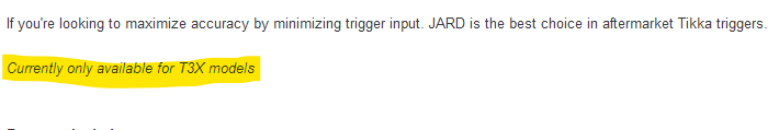

Looks like they are back to having one for the T1X. From the website"
If you're looking to maximize accuracy by minimizing trigger input. JARD is the best choice in aftermarket Tikka triggers.
Available for both T1X and T3X models
Yeah they had the T1x back up a couple weeks ago. I forgot to update here
