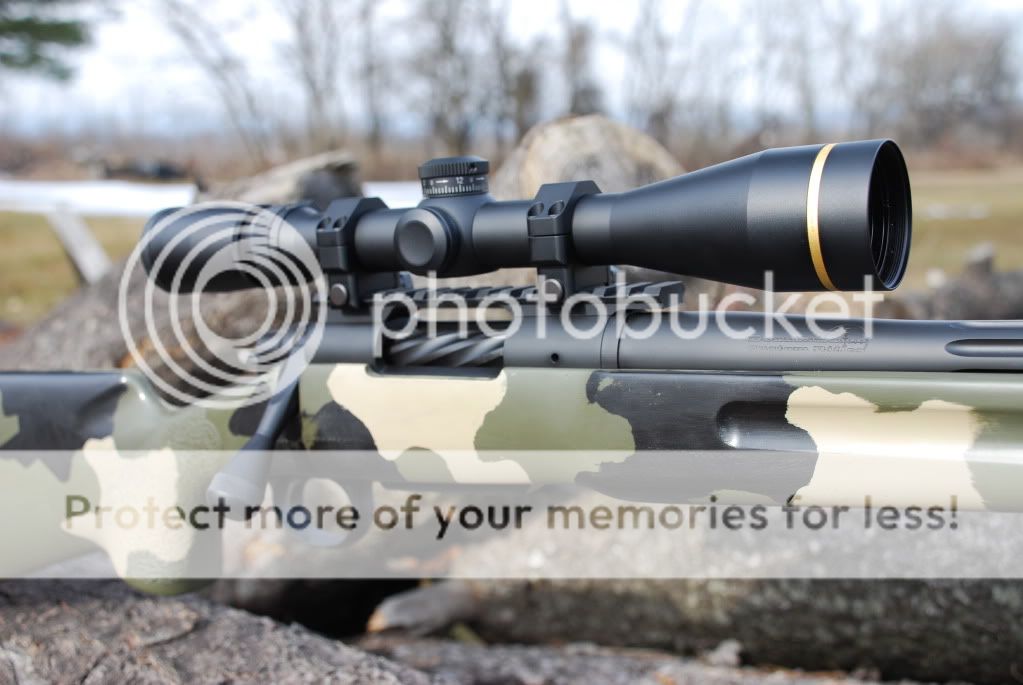

New Hunting Rig in 6.5x47L Beanland Built
Jons built me a few rifles in the past so I finally got around to having him build me a hunting rig in 6.5x47L. Trued Rem 700, Rock 1-8 RV finished @ 20", PTG Handle, Side BR, McMillan A1-3, throated for the 130 VLD's, I wanted BM with a mag but didn't want anything sticking out of the bottom so I went with HS BM ...trying to lose a little weight I had Kampfeld flute the barrel (8 flutes) and the bolt. Badger Alloy 20MOA base TPS Alloy rings, Leupold 4.5x14, bringing her to 10lbs as she sits.
As always with Jon everything turned out better than imagined!!
Now I just need hunting season to come around again :)

I couldn't wait to shoot it any longer even though its a bit cold and windy here so I loaded up 12 rds of H4350 at 40.6 with 130 Hunting VLD's just on the lands, a load that has worked in most of my 47's...so no load developement.
4 rds for sighting in, cleaned after each 2 shots, then off to some 1' dots at 100yrds. Had the chrono set up, I got 2714 fps for the 5 shot average..not bad for a 20" tube..
Top group was 5 with the cleaned barrel, bottom was my last three
