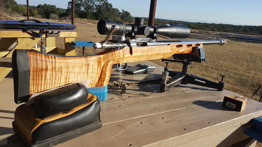

Am in the planning stage of a possible new build, Have a partially inletted stock that's the sister of the one below, and a Borden BRLXD with two bolts .470" and .540" coming. Was thinking of building a big sister to my F-Class Rifle below, built on BRMXD with barrels in straight .284 and 6-Dasher.
I was thinking about a gun for ELR, but have no experience with it. I think this action is too small for Chey-Tak's and the like, and some fellows I talked to recently building guns for the King of Two Mile competition said their builds where upwards of $15K, which is beyond my financial means. Since I have these components already, was thinking 1500-2000yd might be within reach with cartridges like the larger .300 or .338 magnums. Haven't decided on anything yet, ideas, advice & suggestions welcome.

Of the cartridges you list only the 300 WSM, and 7 RSAUM will fit a .540 bolt face, both go subsonic around 1400-1600yds. My .284 will reach that 1400 before going subsonic. Even the big .338 Lapua goes subsonic around 1,850yds. So looks like ELR would not be practicle without a bigger action. So your suggestion is probably the best choice.

For a Borden BRLXD Action I feel that the previous posters have given some pretty accurate advice. That action is sized for approx. a 30 Nosler caliber as far as maximum length for good functionality. And as has been stated ELR isn’t a bargain basement type proposition. There are plenty of other disciplines that you could engage and probably be satisfied with such as F-class and 1000 yard BR. If you are interest there will be a E2k shoot in August in Townsend, MT where 2000 yards will be the range distance and I’d expect a variety of calibers to be competing. Course of fire will be for group (5 shots) and score on the MR-1 size target. There are some threads posted here, in the ELR and Balistics Sub-forum to gain more information if that is something your interested in. 3 different classes, 2 of which will be bi-pod shooting from the prone position and 1 in unlimited from a bench.
