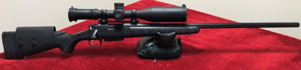

My gunsmith (Defensive Edge Rifles) has his version of a 22-243 Improved he calls 224 Terminator. I don't know the exact reamer specs but it's basically a 22-243 Imp w/35° shoulder. Fully formed cases (Lapua brass) holds 56gr H2O.
Mine is built on a trued Rem 700 w/Krieger 8tw barrel and HS Prec det. mag setup. It sends 80gr ELD-M's out of it at 3650 and it's shooting those really well. As you can tell from the pic below my rifle is certainly no LW build it's got a little weight to it so recoil is almost nonexistent.
One of the things that's really convenient with DE and all of their Terminator cartridges is they offer formed Lapua brass that is ready to go at a very reasonable price so you don't have to bother with or use up any of your components fireforming.

My version is close to the Middlestead...but not quite. It's more like the full length 22-243 40* shoulder, but a 30* shoulder. Does 3640 fps with the 75 gr Hornady ELD and a Kreiger 7.7 twist 29" plus brake. It's been really accurate to 1200 yds. I've taken a number of PD's out that far with it. 3rd picture is a 100 yd group. 4th picture is a 1000 yd group (about 3"). Panda RBLP action, Krieger bbl, Jewell trigger, Shehane ST-1000 tracker stock.
