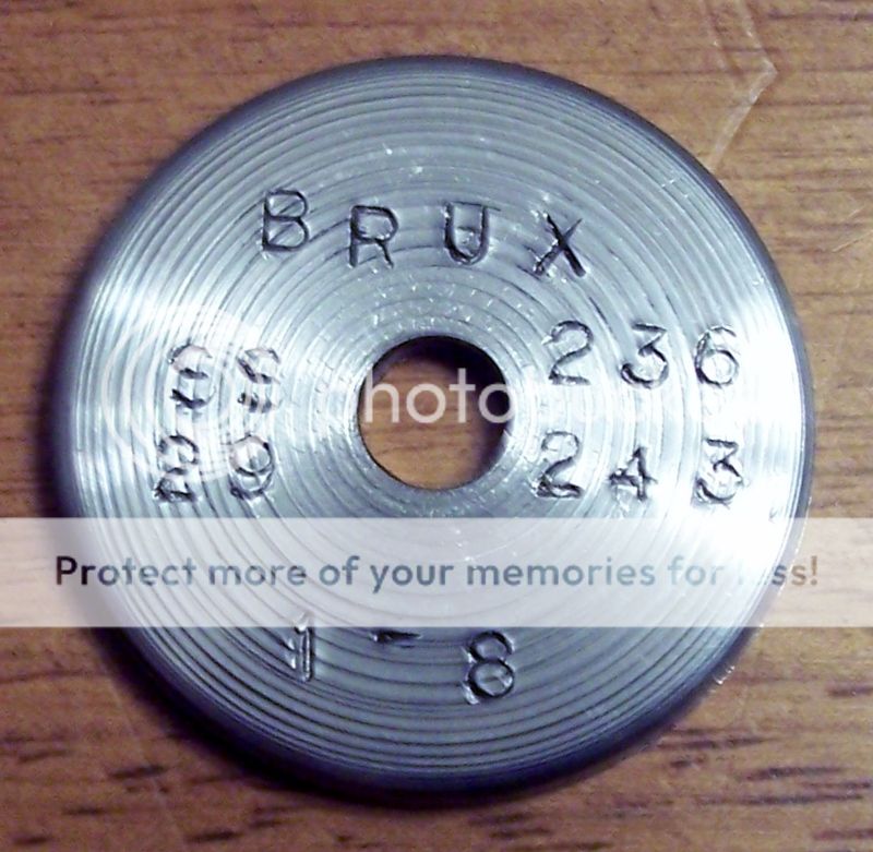

new Brux BR-DX
new Brux straight taper 1.250-1.100 at 28 inches,.236 .243 8 twist .138 freebore 6mm BR-DX done by Claunch Customs Memphis Tn,
started +.013 in the lands .8 grs light of my first barrels favorite load,,first shot on paper and cleaned barrel and shot 3 shots to get zeroed at 100,,gonna dial up 10.5 moa and start load work at 600 yards,,
