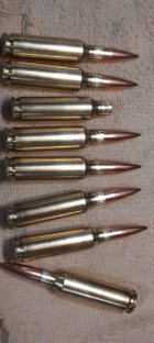

The necks were the worst part. Different thickness, with the case mouth being the thinnest.
After sizing with the bushing, the mouth looked like an M die was used to open it. The lower part of the neck, closer to the neck/shoulder junction held the bullets.
Had to use a smaller bushing.
The weird sizing marks are from different thickness in the neck.
Contacted Hornady about the problem brass that came as loaded ammo. Hornady would NOT replace the bad brass.
CRACKED NECKS-View attachment 1529913
