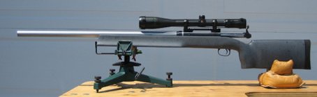

Here's the new barrel on my rig. Only thing left to do is install the SSS tactical bolt handle when it arrives.
shcal

wow, very nice man, I think the strongest Savage action you can get is the SS version. The bottom is not milled out so it has the extra metal. Anyway seeing guns like that make me wish I would have went the savage route instead of the Rem route on my 7mm. I have 1500 in a gun thats one barrel and no chance of taking it off till i blow the riflings out of it as much as it cost. Very nice gun man hope it shoots like a champ.
LOL just noticing I have that exact same Front rest and rear bag, and maybe even the same bench
Hey, that is a nice lookin set up. Just to pass along another tip: After my barrel installation is complete, I always run a stripe with black magic marker horizontally along the nut and barrel. If the barrel begins to unthread, it can be detected before there is a problem,I did have a Savage factory barrel unthread while I was at the range).
