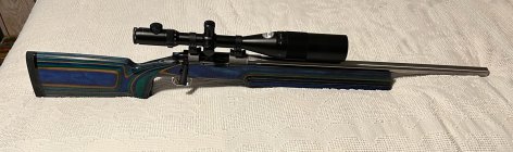

The new Splitter 2 build. 6bra 104 fb. 8 twist Wilson.
From yesterday evening Last rounds I shot after 50 plus rounds at 107 degrees. Final two groups. Hot barrel.
