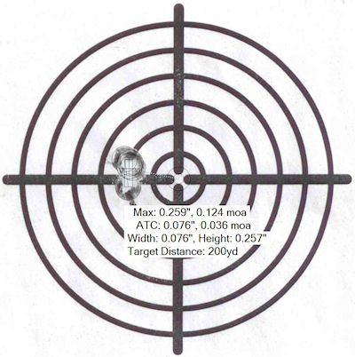

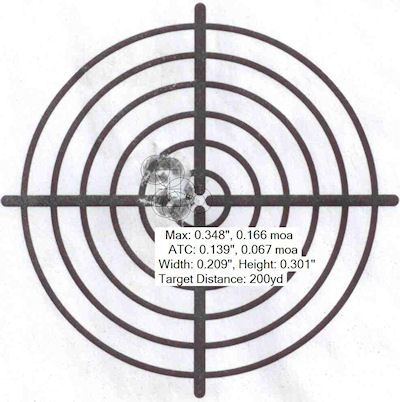

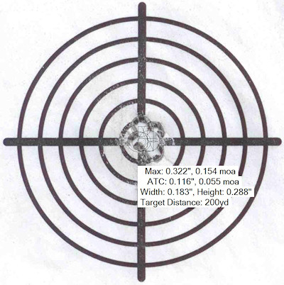

I just finished a new 6 Dasher rifle build, this time on a BAT model B action:
I went to the range today to fine tune the RL-15 loads, and came away with a big grin. ;D You can see the complete writeup on my site here, but here are some pictures of the (5 shot) groups @ 200 yards (Yes, 200!):
These were 105 Berger VLDs, running 3075 FPS. SDs were about 3, with ES about 8. Can't wait to get to the next F-Class match!

I can do the same thing with a 6mmBR in a factory Savage with no wind. I think you overpaid for all that trick stuff.

Great Shooting Chris. Four out of five groups in the Ones... I'll say you have a shooter. And don't worry about Mr. Shot410 ... He may not have realized the targets were at TWO Hundred yards.
We've also tested two Savage factory 6BRs. Even on their second barrels (provided by factory to fix flawed chambers), they couldn't come close to a 5-target agg like that.
