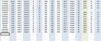

Back in April I received a box of Alpha .308 and because the case mouths had burrs on the inside and outside, I chamfered and deburred them before loading and firing for the first time. As you can see in the pic below (line dated 4-28 with 80 rounds fired), that first firing gave me really good results. I also took various measurements to see how they compared to some of my other brass I've used (see pic below).
