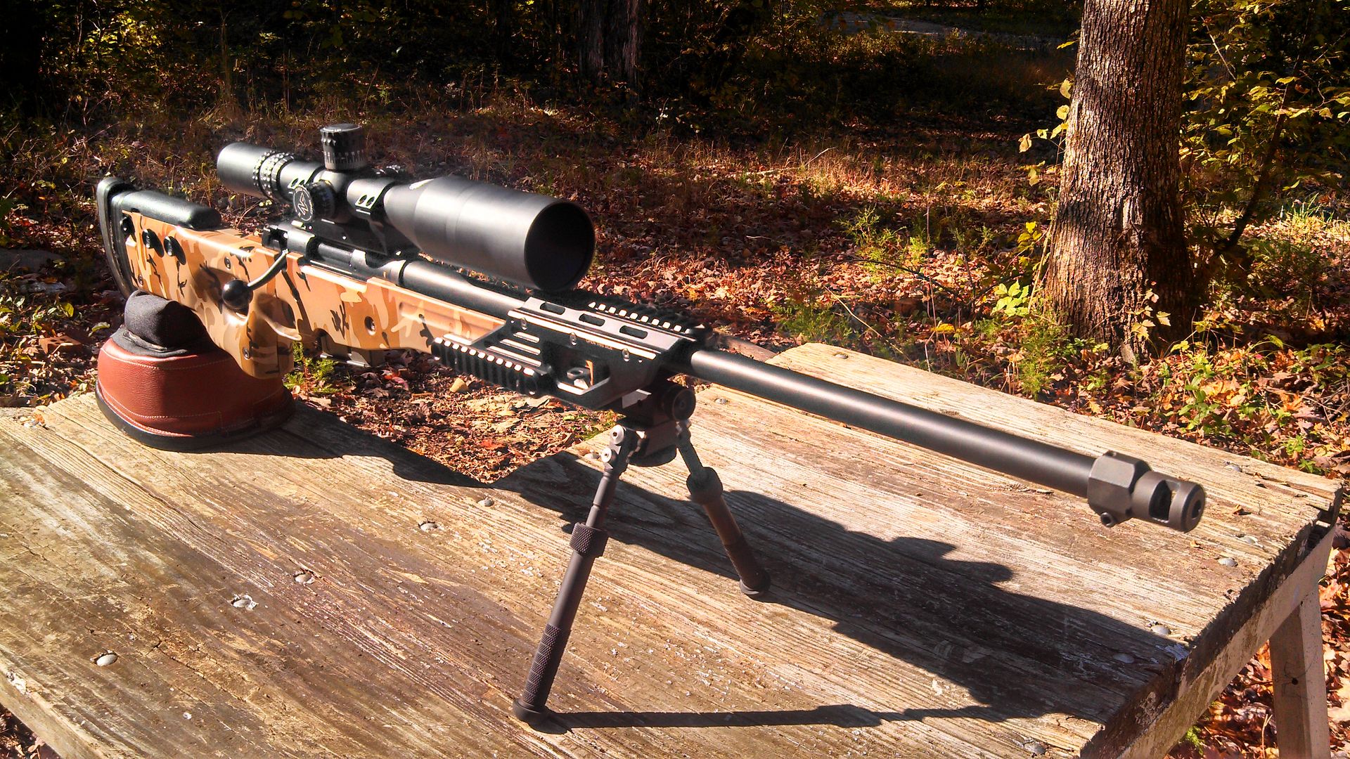

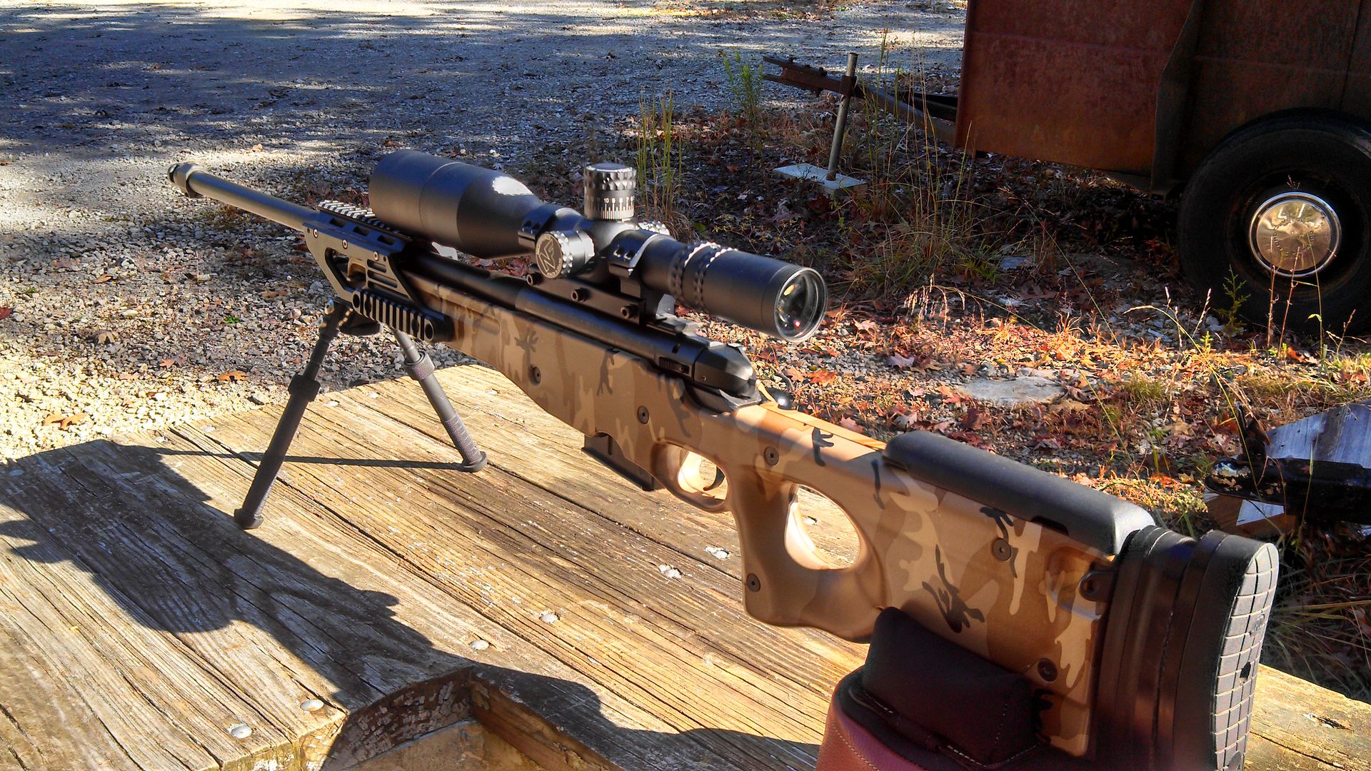

You said "build" if your looking to strip the OEM chassis off and get into some mods,I went with the Rem 700 SPS Varmint. Reasons being is Rem has a $75 rebate on the SPS's. The stocks on the SPS's are literally throw away POS's. I purchased my SPS from a local Bass Pro for $639- $75 = $564 net . Pretty good deal I thought. I added a Bell & Carelson Medalist Tatical stock, a Sightron SIII 8-36x56 scope, and a Kahntrol muzzle brake and i'm good to go for out to 1K yds. Absolutely LOVE the rifle. If your just looking to open up the box, and start shooting as is, and keep it that way then the Savage might be a better choice. Here's a pic of my simple meat and potatoes shooter:
