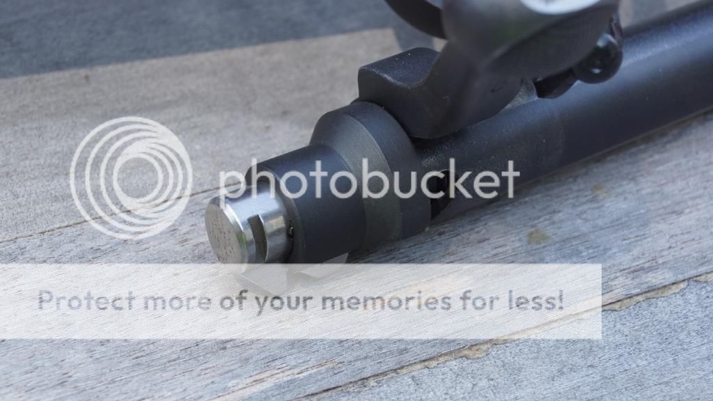

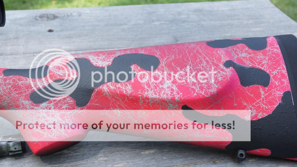

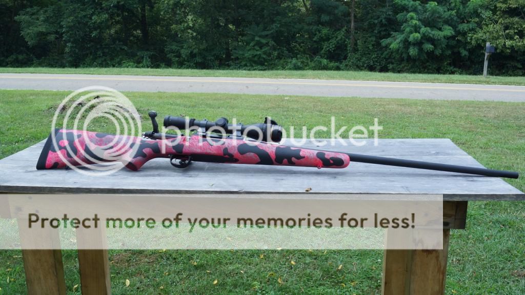

Specs:
Model 7 Action with bolt face opened from 223 to 308 and Tubb 2K extractor added.
Bell and Carlson Alaskan Ti stock with one off paint job (didn't want to lose it in the woods)
Pac Nor #2 1-10" 3 Groove finished at 25" (speed demon length)
Talley bases/ Talley Rings (8x40)
PTG CM Model 7 Bottom Metal
Shilen Trigger(Standard)
PTG 22BR Reamer (.252" NK with .050"FB)
All metal coated with DuraCoat Flat Black
Leupold 3-9x33AO Rimfire Scope
Adam
Sounds like it will be a shooter! ;) It is different! I like it man! You will have to show us some targets now. ;D The only thing I would question is the rim-fire scope? ??? :)
