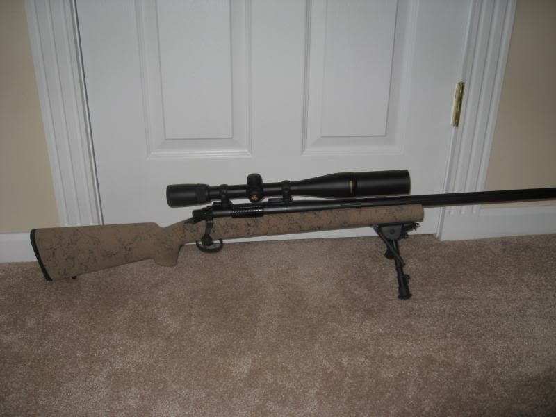

My varmit rig....
Rem 700 VSF .17 Fireball,H&s Stock,Harris Bi-pod topped of with a Nikon 4.5-14x40 Mil Dot scope.
