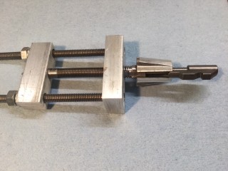

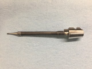

With the scarcity of information and difficulty to reach help about Nesika Bay actions, I would appreciate to know of a source of firing pin & spring for a model R (smallest model of their BR line, the firing pin measures 5.5345 inches in the first picture). I made myself a tool to disassemble so I could at least get the specs of the spring to no avail (second picture).
You will notice that even a fully compressed spring will not allow to unscrew the firing pin from the shroud.

Yes, the firing pin screws into the shroud. You can find my thread about finding a replacement firing pin here:
