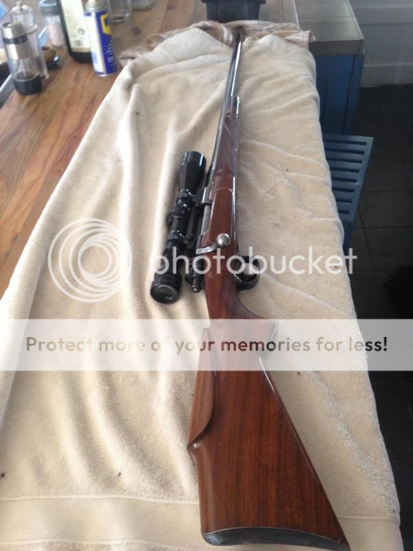

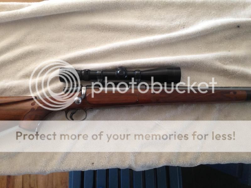

I will get a case length before sizing tomorrow when I get home and it will be a hunting rifle but i would like to get it shooting at least 3/4 MOA if possible. Here are some pictures of the rifle i finally got taken.
