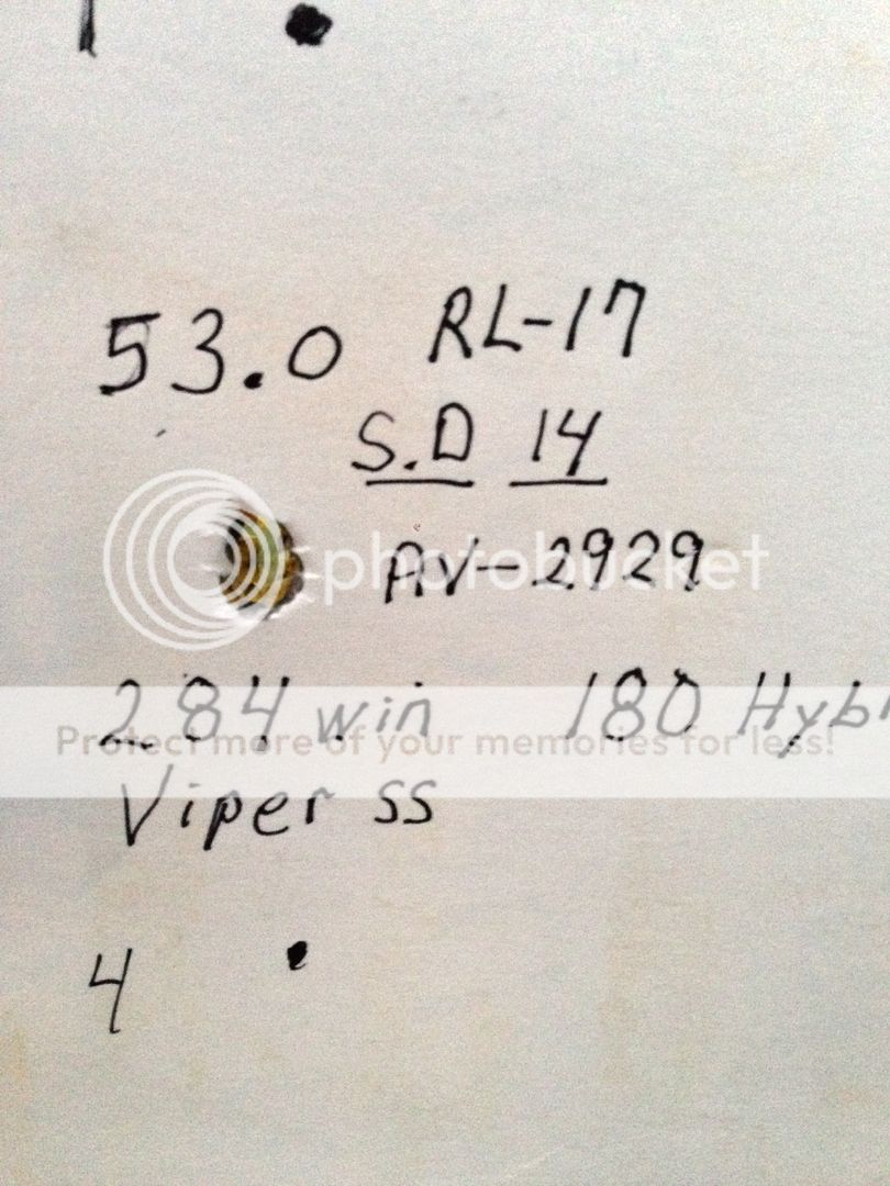

RL-17 53.5 gr SD=1
3 shot groups
She opened up at 54 gr and I only shot two shots as SD went to haywire
but 53 to 53.5 shot great.
this load broke an egg last Saturday at 1428 yards on the 6 th shot
