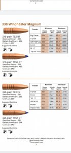

Had a chance to brown bear hunt dropped in my lap and need some load data for a 338wm shooting barnes 225 tsx bullets. I have a fair selection of hodgdon powders to choose from.
Any suggestions/starting point appreciated.

Trying to come up with a guesstimate starting load.
I have not used mono bullets before and have read they behave different than cup an core.
I have no personal experience but looked in my Barnes Reloading Manual No. 3. It is old and pre-TSX but I have found it to be a solid reference for tsx and ttsx. For the 338WM and 225X, it list the following Hodgdon loads:
Varget* Starting 57.0 Max. 62.0
H380 Starting 60.0 Max 65.0
H414 Starting 63.0 Max. 68.0
H4350 Starting 62.5 Max. 67.5
H450 Starting 69.0 Max. 74.0
Interestingly it lists Varget and IMR 4350 as the most accurate powders tested. Hope that helps get you started.
And congrats on the bear hunt! I hope it goes well for you.

Thank you very much for the data it is just what i was looking for.

I shoot Accurate 4350 with great accuracy behind 210 TTSX’s in my .338 WM for bear. I’m testing out Hybrid 100V and 225 TTSX’s next trip to the range which is probably this weekend. I have a friend that loads Hunter and TTSX’s in his .338 WM, .300 WM, and .30-06.
