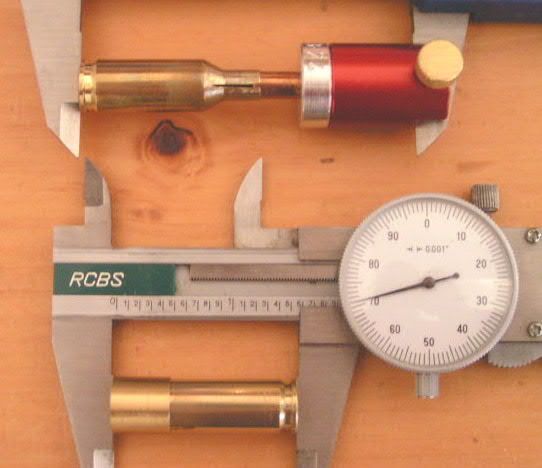

Look at the upper case in my pic. By using a resized case with a slit neck you can make your own seating depth tool that is basically free and far more repeatable than the Hornady tool. If you aren't measuring how far you are bumping your shoulders back then it is probably best to just neck size the case before you slit the neck.
