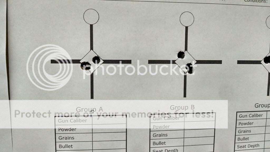

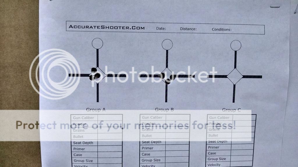

The first target below is with 42.0 with the bad primer 95 es (2744 to 2834) seating depth 2.175 (30 off lands)
The second target below is with 42.0 with the good primers 11 es (2802 to 2813) seating depth 2.175 (30 off)
The third target below is 41.7 with good primers 24 es (2773 to 2797) seating depth 2.175 (30 off)
So of course as you see the first target is what I am trying to achieve (smallest group with a GOOD es 15 es or less) but that was with the bad primers. Now with the good primers I am printing anywhere from 1/3" to 5/8" and it was consistent from load 41.7 and 42.0 load. SO my question is now do I mess with seating depth since I know this gun can do one hole groups but the seating depth was the same throughout all testing. This first target is not the only one with the bad primers that I shot 1 hole groups I shot this over and over did about 7 groups just like this on different days so it was not a fluke group to say. I know if I mess with seating depth it will change my es/sd a little hopefully not much. Or should I stick with 42.0 with 1/3 to 5/8 and shoot it at 400 to 700 yards and see what the groups look like there since I have a low ES/SD?
