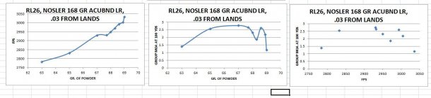

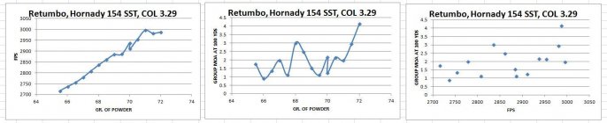

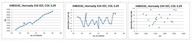

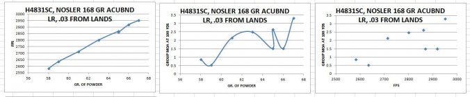

I am having the worst time finding an accurate load for my rifle. I am shooting a Remington 783 7mm Mag. I have had it for a year and was not satisfied with the accuracy of the factory rounds so I started reloading a few months ago. I started with H4831SC and a Hornady 154 SST. I have since also tried Retumbo/154 SST as well as H4831SC/Nosler Accubond LR 168gr and RL26/Nosler Accubond LR 168gr. I have only been using Hornady cases and Winchester WLRM primers. I did try varying the seating depth a little as well. Mostly done at normal COL, but some done at 0.03 off the lands.
All of my shooting has been off of a led sled.
My goal is to get something from 2950 to 3050 fps for a hunting load that I could confidently shoot out to 600 yds. So, if I can get repeatable 1 moa at 100 yds, with those velocities, I will be happy.
I have been able to hit 1 moa or less at times, but not at the velocities I would like.
Here is all of my data in the pictures below. Most of the data is using 3 shot groups, but a few had 5 shot groups. If I can't get 1 moa or less with a three shot group, then the 5 shot group is pointless to try. Isn't it?
Please give me some guidance as to what I should try next.

I think I see some similarities in your groups across all the charts you put up. It appears that all the loads as you approach the higher velocity group close
to the same level of MOA. If you overlay all the charts can you chart out you averages based on velocity?
