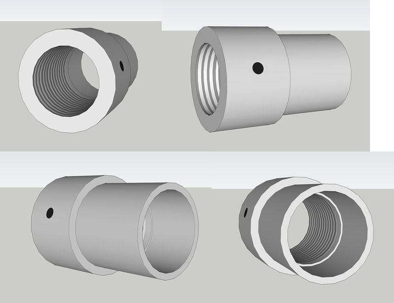

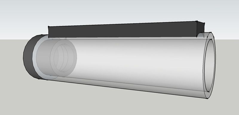

So here are a couple images of what I'm thinking. The whole goal of this project is to be able to mount a forward rail. But I want it connected and secured to the action itself, not just attached to the stock like some systems.
So really I'm looking at a savage or remage barrel nut (still sourcing the action) that is also threaded on the outside. Then an aluminum tube would be threaded to it, a short section, something like 7-inches. and a rail attached. I would mount the rail after everything is tightened down and headspaced
You could bore a piece out that fits on the barrel like a recoil lug with a shoulder inside and threaded on the outside to fit the free float tubes on the market. That way you dont have to halfass it with a barrel nut. Dont know if thats what alex meant or not. Think of it slipping over a barrel shank and stopping like a lug but go over the outside of the barrel with the big threads on the outside

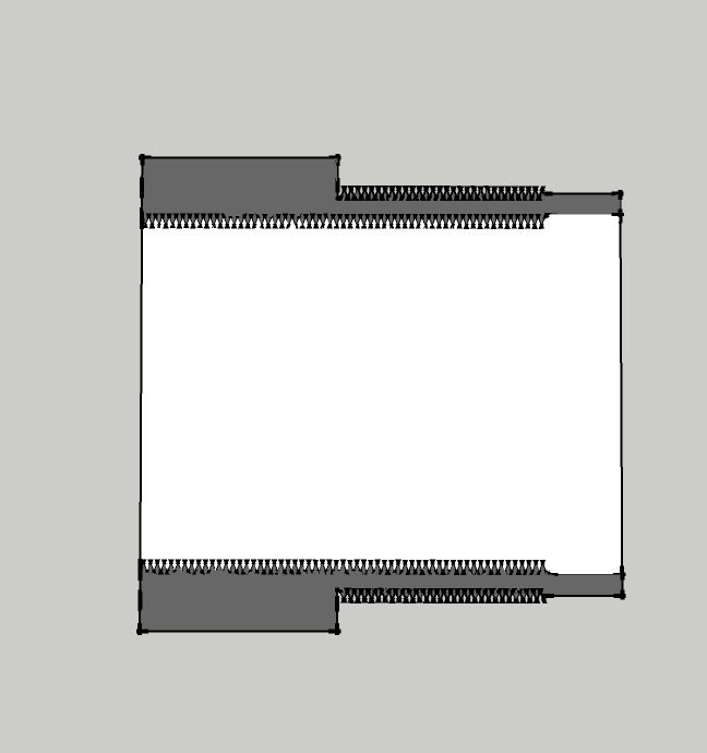

So, focusing just on the nut, not the whole thing. I believe this is workable. Nut would be about 2.5-inches long. Face that would shoulder into the nut about .25-inches. the front would be cut down to allow a tube of some sort to be glued on. If the tube is slightly proud, no biggie, just want it to shoulder so I can maintain access to the pin hole which would allow the use of a pin wrench to tighten.

I did. But I'm back at how do I get it threaded? But I guess as long as I find something that matches the OD....back to the glue on. And its only 20 bucks or so to try one out.
