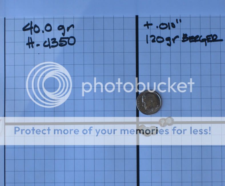

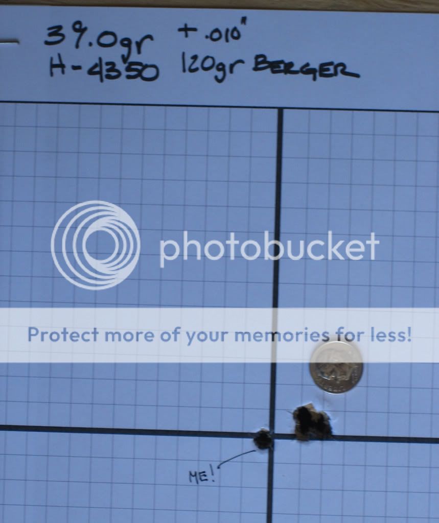

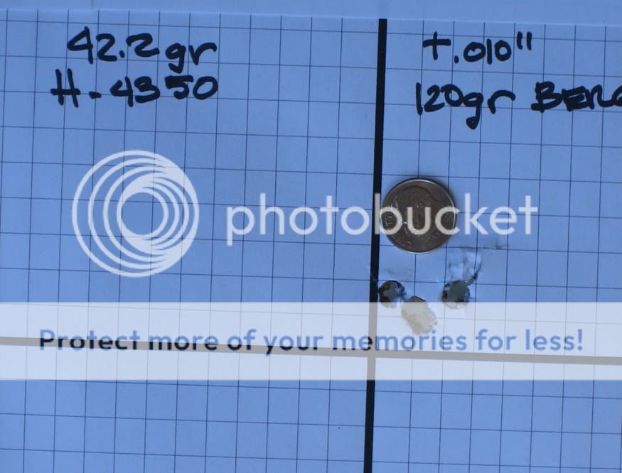

I got out early today before the winds started and did some testing with H-4350. These are the best three loads. I started at 39.0 gr and went up to 42.2 gr. No sign of pressure whatsoever.
39.0 grs was very good. The four shots touching measured .282" all were shot at 100 yds. The one flyer was really me, I pulled and the second I did it I knew I screwed up! Oh well.
