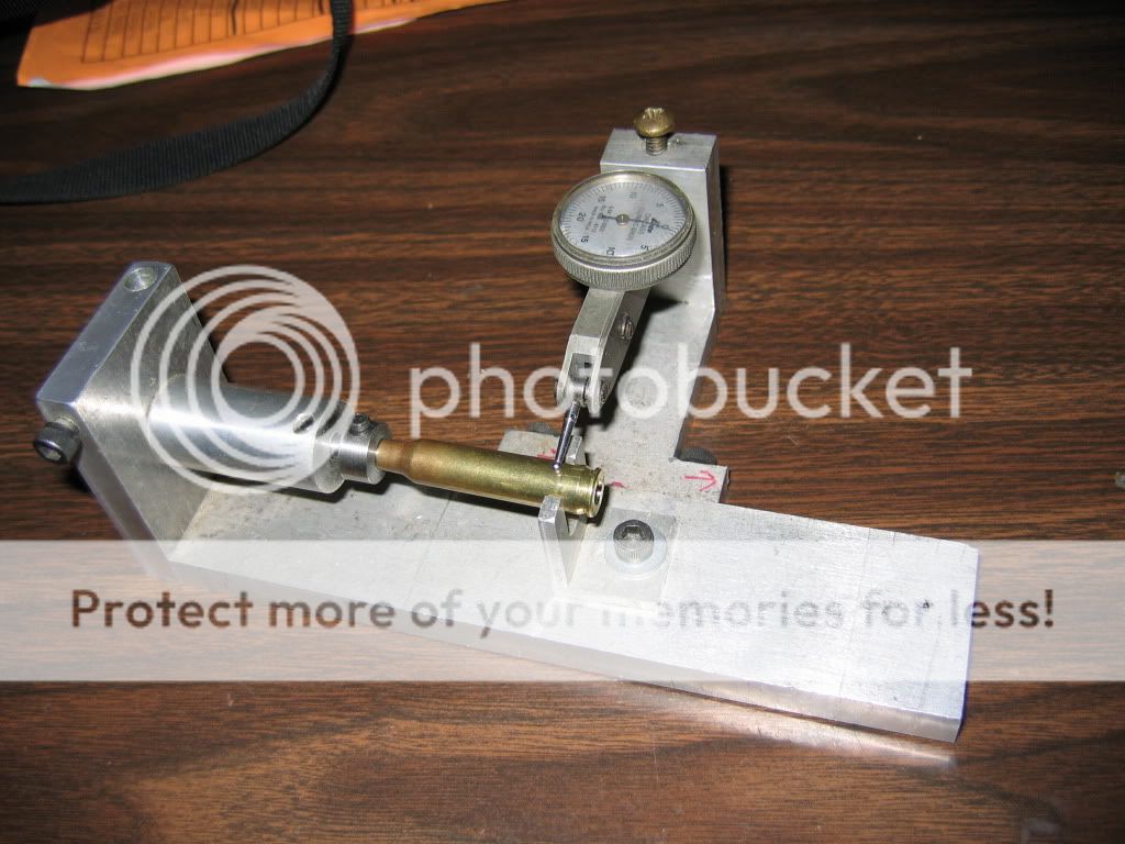

Yes it is a home built device. My friend made it to gauge case wall thickness runout back near the head. He sorts that way. I should have taken a picture without the case. the mandrel has an offset so that it only touches the inside of the case opposite where the indicator touches the outside. There are interchangeable sleeves that fit various calibers' necks, and a stop collar, as well as the bracket near the back of the case that keeps it aligned side to side. He can sort cases really quickly with this tool. His has a busy retirement, and his legs and back won't take as much shop work as in the past, or I would have one. Interiors of cases can be offset parallel or canted,with respect to their exteriors, so what you get at the neck may not tell what you have farther back, and unlike the necks, that can be turned, you are stuck with the consequences of runout farther back. I was the one that told him about Creighton Audette's writing on this subject. He took the ball and ran with it. That was many years ago.
Ok so you are performing the same measurement as seen here in the Riflemans Journal. It is stated that it takes about two minutes to screen each piece of brass. In a box of lapua or norma brass have you done enough screening to say roughly how many pieces you would expect to find with greater than 3 thou runout at the web?
How about cheaper brass? The DVD I watched where David Tubbs performed this screen on the Neco tool he also mentioned indexing cases to ensure that thick/thin regions were aligned with the bolt lugs. Are you going that far?
