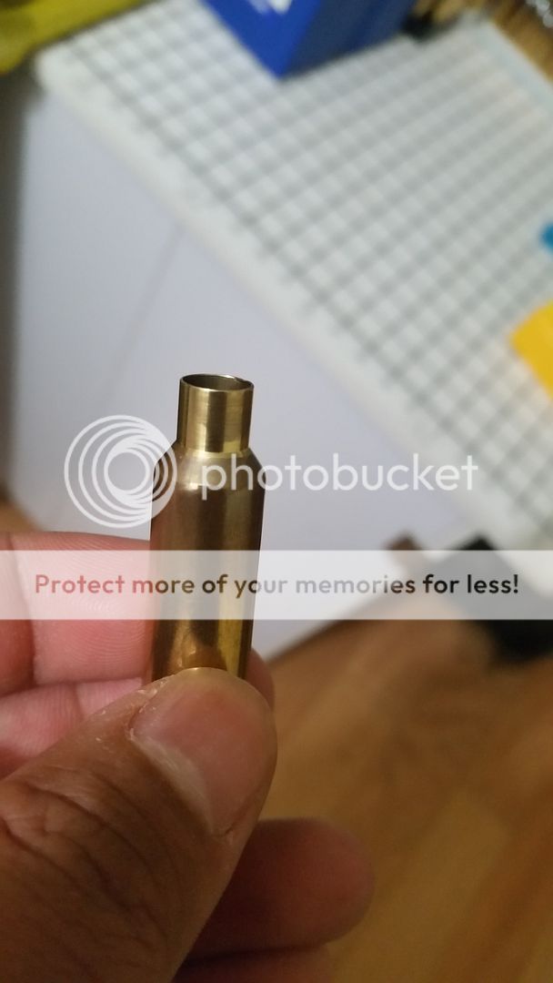

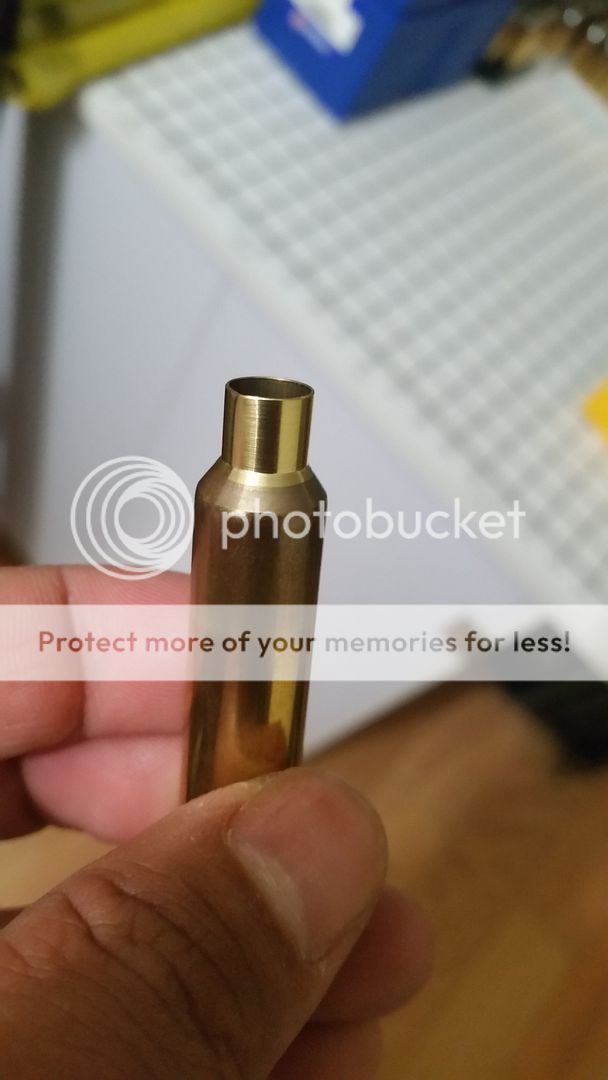

I was working on a new lot of Lapua 6.5x284 brass. I lubed them up, expanded them with a 7mm mandrel, and then proceeded to turn them on a PMA tool with a 35 degree cutter. I have turned necks before on 6BR and 6.5x284 lapua brass necked up.
I am cutting the neck to ~ 0.014". With a mic, I am seeing virgin brass anywhere from 0.0135"-0.0155", at least on this particular lot.
The problem (may not be a problem and is more of an observation) I am seeing is that when I get down to the neck region, the cutter is cutting a little more of the shoulder on one side and is cutting more on the side where the neck is thinner (0.014 or less) and the cutter is barely touching it or not touching the neck at all. See picture below.
I then cleaned them up and proceeded to load a dummy bullet in there and I am getting about 0.001-0.0015" runout on a loaded round into the neck I just turned, so it is not bad at all.
I am wondering if you guys have seen this before. I do not think it is an issue, but it is interesting because this means that the shoulder area that is being cut more, is thicker.
To make sure my set up was not wrong, I took some older lot # lapua brass that has been fired a few times and is unturned, used a neck die to neck the whole neck down, then expanded it and turned the necks (cutting the donut out) and the shoulder came out much more even. I also took the new lot # brass and fireformed 1 piece, necked it down, expanded it and turned it and I still have an "uneven" cut on the shoulder. Could it just be that I have one side of the brass that is a little thicker at the shoulder and I should not worry about it?
You can see that the cut is shallow on the shoulder and at 12 o'clock, you can see on the neck that the cutter did not touch a portion of the neck.
This picture shows the same piece of brass where the cutter cleaned up the neck, but the shoulder cut is much further down the shoulder.

Honestly, I have not checked them, but I would understand if the cut was deeper or shallow, but in this case, the cut is shallow on one side and deep on another side.
I will check OAL when I get home and will also see if maybe the OAL is uneven on one side versus another, but that seems unusual for Lapua brass.

So I measured my brass and all the tips were relatively straight and more or less, the same OAL. The fact that there might be a difference in OAL of the brass should not be causing the cut to be further down the shoulder on one side of the brass versus the other, especially if the mandrel and ID of the brass neck is tight and has very little play in it.
Yes, I let both my hands (one holding the turning tool and the other holding the drill) float, meaning if it wants to wobble a bit, I let it do so and do not force it to stay straight.
I am really thinking that the brass thickness at the shoulder is slightly thicker on one side versus another, especially given the fact that I am seeing anywhere from 0.0135-0.0155" in varying thickness at the neck. I cannot imagine this variation in thickness is only on the neck. Hence, when I get down to the shoulder, it will cut more material on the side that is thicker.
Is my train of thought flawed?
