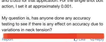

My question is, has anyone done any accuracy testing to see if there is any effect on accuracy due to variations in neck tension?
