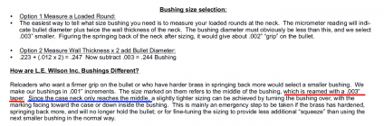

Since bushing taper was mentioned, I dug into the LE Wilson bushing, it's a tapered design according to the user manual for the die:
The partial sentence underlined in red is a bit of a puzzle: Taper should normally be stated as distance-per-distance, a ratio, or an angle with respect to a reference line, I have no idea what a .003" taper is. Nevertheless, using pin gages on the .267" bushing I have indicates it's diameter is smaller at one end than the other. Using minus gages, the unmarked (bottom) end of the bushing will almost accept a .267" pin, a .266" slips in easily and gets tight-ish at the other end (top) of the bushing. Absolute dimensional agreement between the bushing's stamp and it's measured dimension aside, the little bugger is tapered.
The partial sentence underlined in blue is a mystery to me; the bushing is nominally .375" tall, a 6br neck is nominally .322" long. Further research required :confused:.
