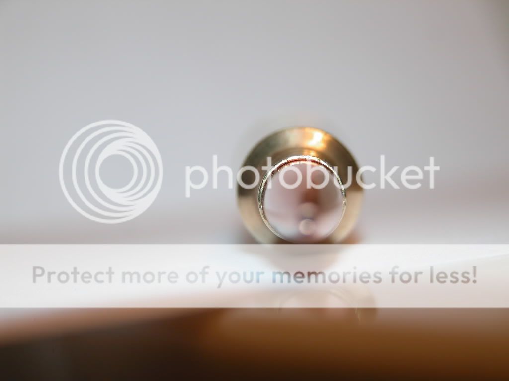

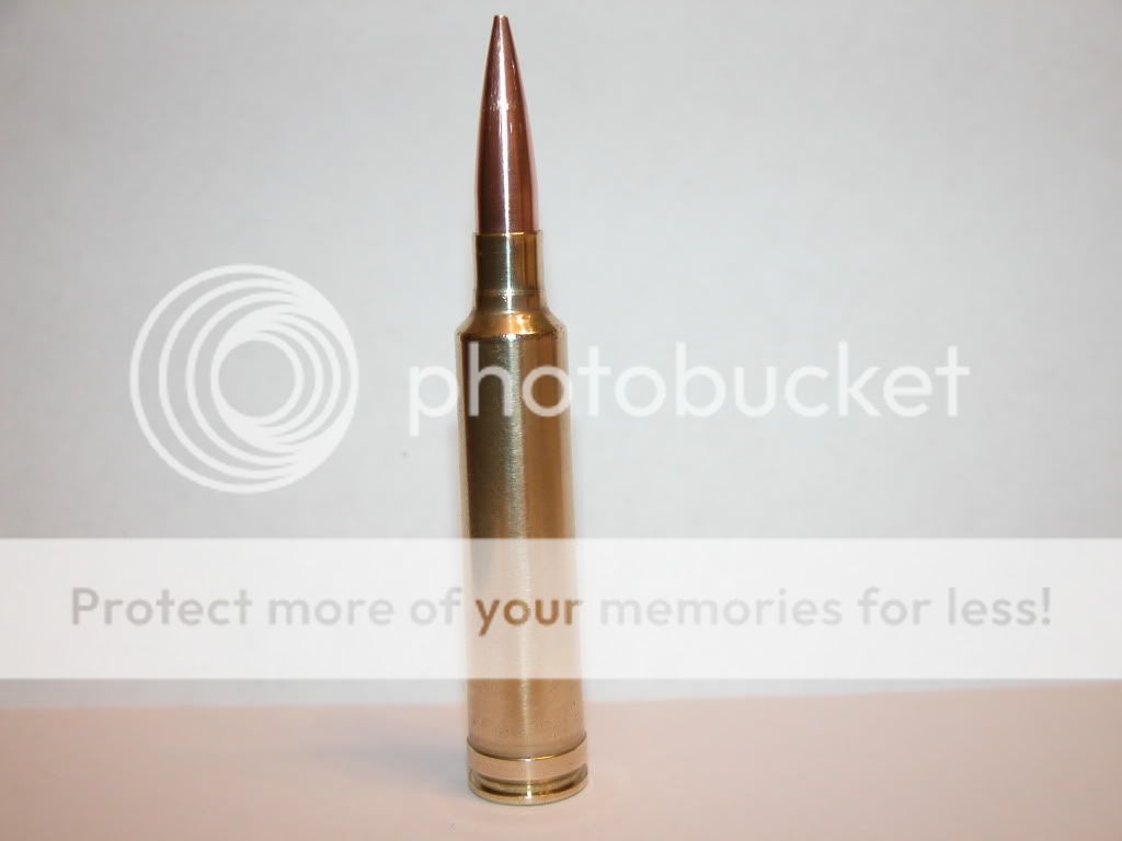

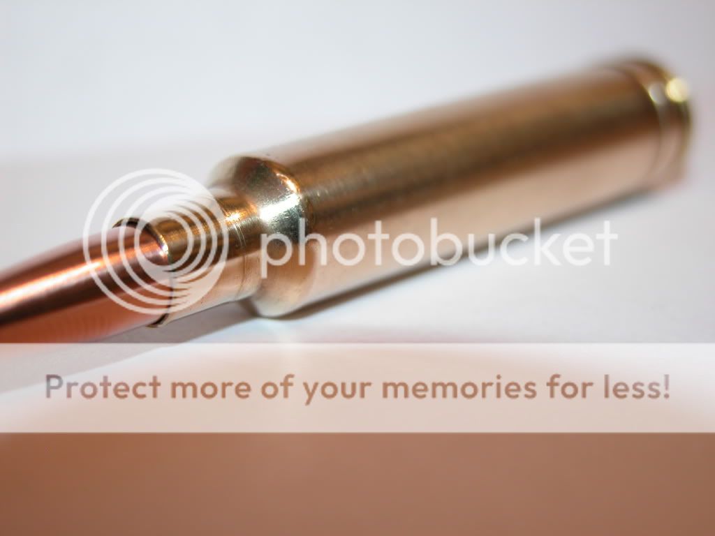

..before you make an educated guess...here are some specs and photos.....
BTW.....Dave Kiff at PT&G is making the reamer.....I ran the neck through a different bushing die [that was obviously SHORT].
Here are the preliminary ballistics:
6.5mm 140 gr. Berger VLD
ACCURACY LOAD OBT = 1.345ms
Barrel Time = 1.344ms
COL = 3.265"
Powder = 57.1 gr. Reloader 17
Velocity = 3,183 fps
Pressure = 53,268 psi
MAXIMUM LOAD shows:
Barrel Time = 1.293ms
COL = 3.265"
Powder = 58.9 gr. Reloader 17
Velocity = 3,262 fps
Pressure = 58,325 psi
For a 30.5" barrel:
the "venerable" 6.5-284 needs 59,157 psi to achieve 3,060 fps.
the "revered" 260 REM needs 59,874 psi to achieve 2,935 fps.
Want to know something else truly AMAZING....this cartridge will achieve
3,062 fps with 48,400 psi.....hmmnnn.....
....keep guessing.....it's amazing that this cartridge has been OVERLOOKED for so long....

...we have a WINNER....good job Bob!
yes indeed...the 7x61 S&H
..actually the 7x61 Super:
my gunsmith is coining it The 6.5 x 61 Super.....Since the 7mm Remington mag killed it around 1962 or so....Norma decided to relieve the interior walls of some brass...Norma gained about 5 more grains of powder capacity, therefore matching the 7mm Mag ballistics. Norma renamed the cartridge to the 7 x 61 Super.
But..as in a lot of marketing campaigns....the 7mm mag proved to be too popular.
One thing my gunsmith pointed out very clearly...the 40 degree shoulder on the 7 or 6.5 x 61 is/was the only factory produced "Ackley-improved" so to speak...

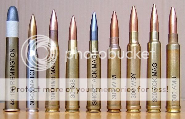

Maybe this might prove interesting
http://www.kailuacustomguns.com/articles/264Thor.htm
I also remember having read about that wildcat years ago... was it in Gun Digest? I'll have to check, I'll keep you informed.
