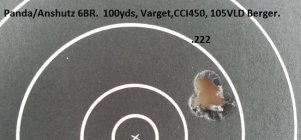

So I have about 500 rounds on her now. Took a chance and went to a couple big matches with it and did not do a load work up before i went as I just did not have time. The rifle has been shooting lights out with the same load as my other 6BR rifle in a tube gun.
Heading to the Nationals for Mid Range Prone in a few days so I wanted to try some of the hybrids. That means a small load work up. All I have to say is WOW!!!! Not only does it look pretty is flat out shoots.
It shot a .222 group at 100yds with my old 105VLD load ( see picture). Once I got the seating depth right on the Hybrids it shot a 5 shot group of 1.6" at 600 yards this morning in absalute perfect conditions. This may not be a big deal for some of ya but for a guy who really is not all that good at shooting off a bench I thought that was awsome. Even better i had a witness to it all. :Looking forward to Camp Perry now.
Russ T

What did you find for seating depth with the hybrids? I also have an Anschutz 6BR that shoots great. I noticed a significant difference with vertical when the bullet tips were reamed and repointed. Are your bullets modified?
Dennis L
I handled this rifle a couple of weekends ago, and it is a thing of beauty!!! Russ...I told you those hybrids would shoot!!
Jim
Russ:
I shot about 300 Nosler 107s this spring in my stoller 6BR and wasnt sure they shot so well. I was using N-140. Switched to 105 Hybrids and it came alive. Jumping about .025 and it shoots pretty darn well. Had 3 15X matches at Lacrosse this spring shooting irons all day.
You will be hard at Midrange with that rig, good luck!
