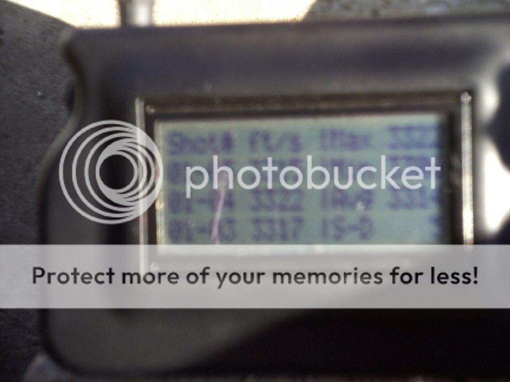

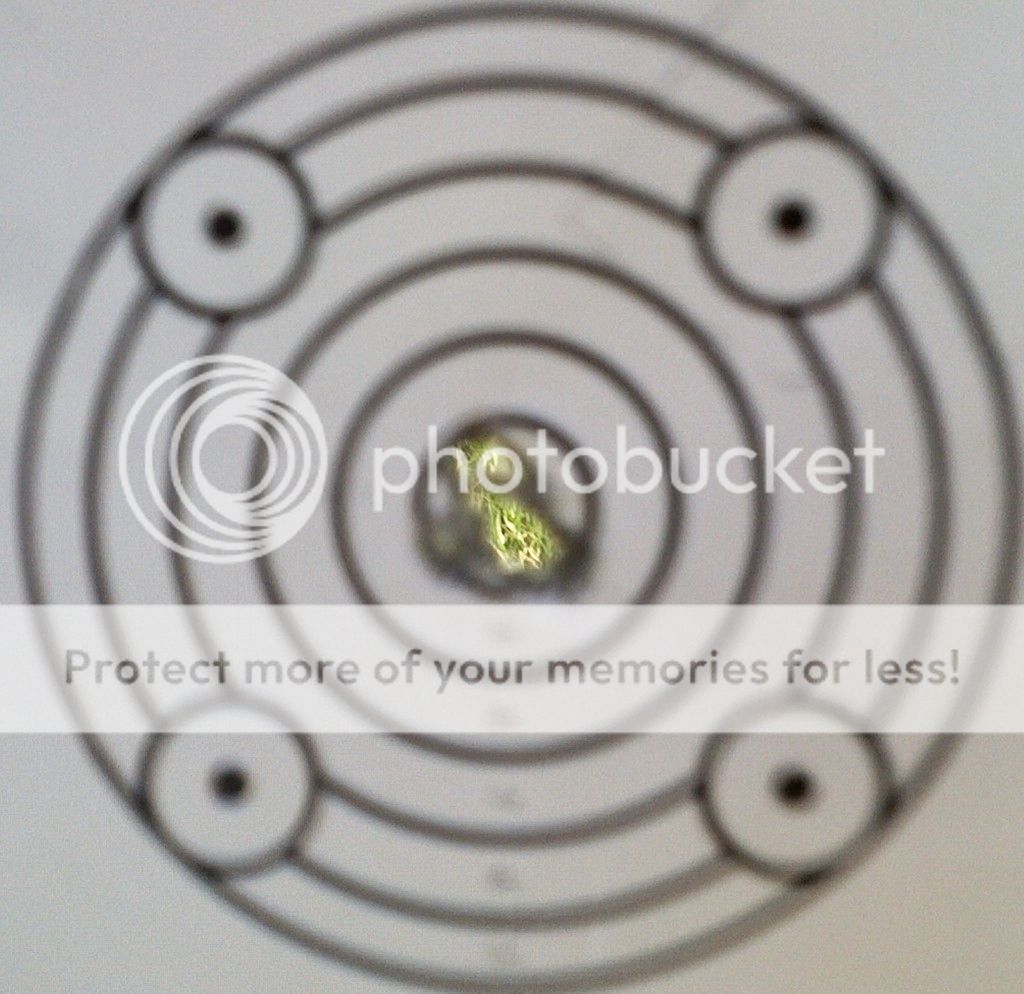

after getting 50pieces of Lapua Palma brass worked for the 243 I started with RL26 to see how the small primers would do with the slower powders on paper and across the chrono,,I am pleased so far but have a lot to do before I will give a firm opinion ,,
Lapua Palma brass
CCI 450
47.5 RL 26

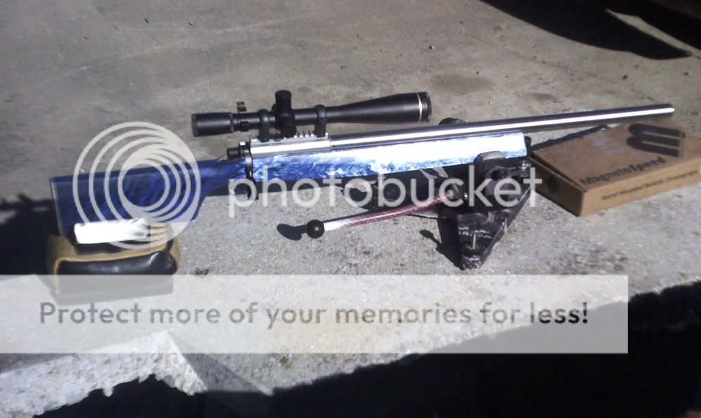

28 inch Brux 8 twist
105 VLDH
5 shots 100 yards .285 at 3314 fps avg with ES 16 and SD 5
