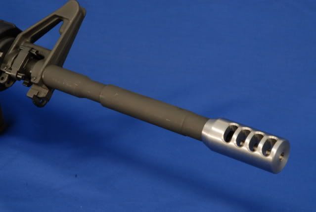

Here's a picture of one that I put on my AR.
It's a 1" that I back tapered to .750"
I also have one on my 1.25" barreled groundhog rifle.
The ports are slightly angled upward so the escaping gas helps with muzzle climb during the shot.
