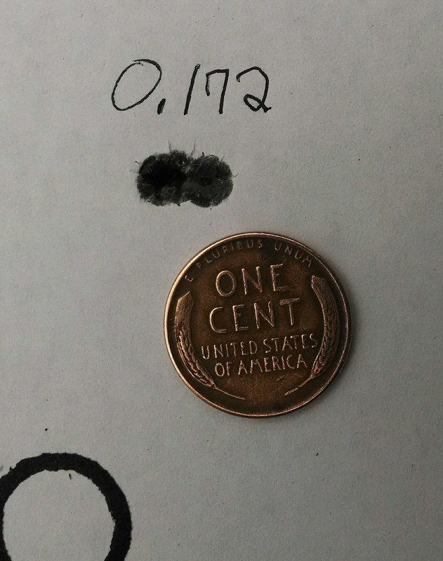

Barnes Precision AR-15 that I just put 20" Kreiger in. Still working up a load for this barrel. Shot my first half inch group ever the other week, first time shooting new Kreiger. I'm not a very good shot yet.
But today I pulled the trigger three consecutive times at 100 yards and did this. Looks a little wider to me, but my buddy measured it with calipers, not sure. Either way, I would like to thank Boyd Allen for making me think about my bench technique, or lack thereof, which was retooled today.

Good shootin' !! The trick though is to make it repeatable and consistent.

Dan,,,great shootin,,,especilally for a AR !!!!.....use all the scope you can get,,,,benchrest shooters usually always have a 36 or 45 X on their gun at 100 yds,,,,and its good to know that you can figure out parallex and scope issues,,,you are on the way,,,,Roger
PS,,,what powder charge and bullet ????

Good shooting though,prolly not a fluke.

+1 to Ackman's response to that statement. If that were even close to being true, all of the becnhrest world would use nothing more than 9X scopes
Great group by the way Dan! I'll be putting a 20 Tactical custom barrel on one of my AR15s in the next couple weeks hopefully. I can only pray that it shoots that good :)
