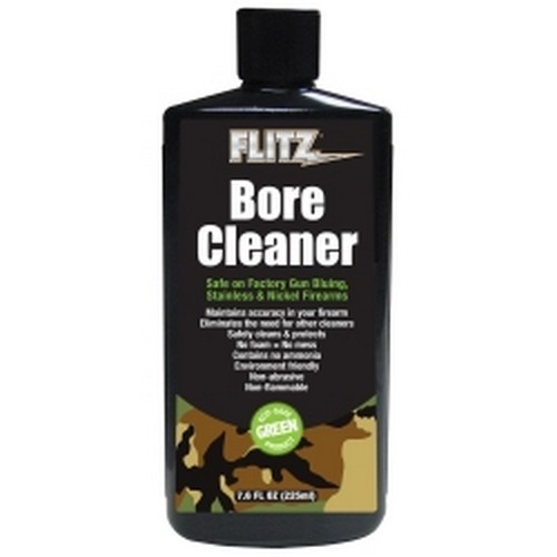

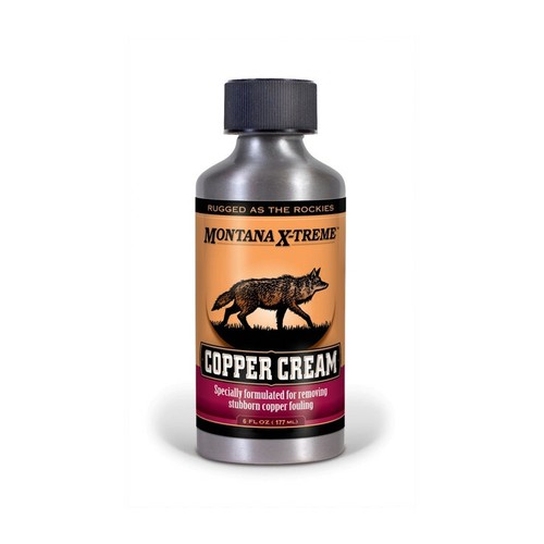

Try some Montana Extreme copper cream, then some Flitz bore cleaner, both of which are easier to use than JB.

I use the Copper cream and Flitz bore cleaner on patches, two or three patches, short stroking usually does the job.

When I tried Flitz the bore cleaner, it seemed to work about the same as Iosso but was a bit messier to use.
