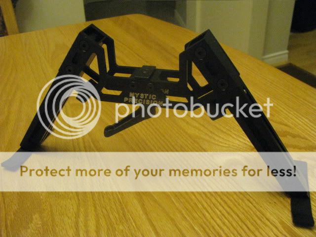

MPOD - 12.8oz installed FTR Suitable bipod
With over a year of development and a few wins to its credit, thought you guys might like to see my new MPOD F TR suitable bipod
Read all the info and options http://www.mysticprecision.com/wp/1709/mystic-precision-ftr-mpod-1lb-installed
At 12.8oz installed, the lightest F class suitable bipod on the market. Lots of great user features including ease of use, easy to store, rigid, great tracking.

ThunderDownUnder, thanks for your kind comments. The MPOD is completely modular and we can custom make just about anything to suit.
We have wider plates to suit larger stocks and are working on smaller/narrower plates for sporter stocks. Legs of longer length are no problem either but the MPOD does cover a huge range of travel as is.
The actual elevation gain is like a Harris 6" to 15" if there was such a thing - over 4" of vertical travel. In prone, you can shoot off a very inclined mound to ground that is angled downhill. Or shoot uphill about 30degs. when lying on flat ground. But we can build to suit.
Measure from the bottom of your stock to the ground when you are in position and see if the MPOD will cover the elevation you need.
I am 6ft tall and shoot with a very "tall" rear bag, scope mount as well. I sized this to fit me and the widely different terrain of the ranges I compete at. Most of the ranges, I am in the middle of the adjustment range. This pic is of my FTR rig, prototype MPOD, Sightron SIII 10-50X60 scope in Burris XTRA high sig zee rings on a Farrell base. Yes, it is way up in the air.
So far, seems to be working for most body types and heights.
The leg footprint gets bigger as you extend the legs so yes, the MPOD remains very stable the higher you raise it. The inner and outer leg fitment is close so there is no wiggling around when locked up.

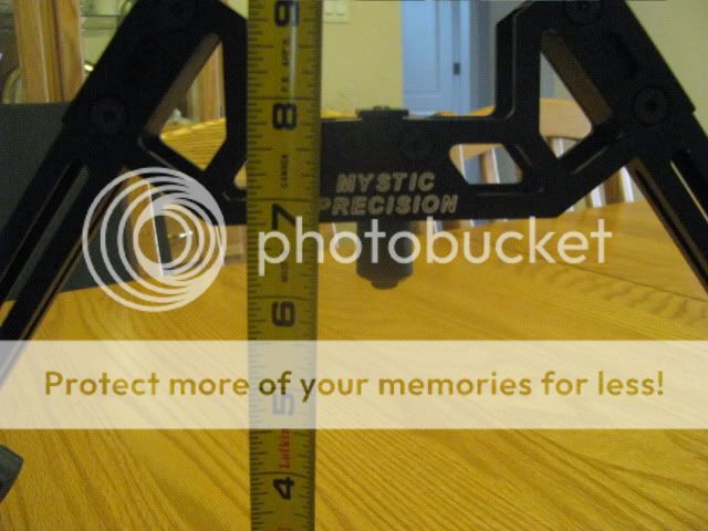

Yes, cant is handled by adjusting the legs. The MPOD will tolerate some pretty steep inclines and still leave you with a level rifle.
I have yet to find a range and even field shooting where the rifle couldn't be leveled. There is a 4" difference in height between the legs.
Jerry
Jerry, thats a good photo showing the 4" difference in the leg height and its something that cant be done on bipods that have both legs connected on a threaded adjustment shaft. A lot of bipods only allow the height adjustment of their legs in parallel, (car jack style) both legs go up and down joined together and tilt needs to be handled by a rotated forend clamp. Seperate leg adjustment is simple and allows for a stable base for the bipod.
Ian
There are some very nice operating benefits to the MPOD design. Some we designed in. Others were happy byproducts. We really weren't expecting the MPOD to tolerate that much of a leg height difference but it does, so there really isn't a concern getting a rifle level.
One aspect of the scissor type bipods was that the footprint gets smaller the higher you raise it. I thought that wasn't ideal as the taller rifle would want a wider footprint to maintain stability. A decreasing footprint just makes the set up more tippy.
Also, when dropped to their lower heights, there is a very real chance of getting bounce - long legs at shallow angles will flex. Solution, very hefty leg designs. The Remple is a rock solid rest but had to be very heavy to gain all that rigidity.
The carbon fibre clones save weight but the legs can and will flex. There is also a risk of being fragile.
It took us a few tries to get the legs angles right but now it sits all on its own through the entire travel range. The legs are at an optimal angle to be rigid and minimal flex. It allowed us to take out a huge amount of weight in the design. Our prototypes were as heavy as 20oz and could support 200lbs - a wee bit overkill.
When looking at some Euro sniper rifles, it was clear that they felt "hanging" the rifle below the pivot centers of the bipod was a good idea. I liked that idea as lowering the CG of the rifle helps use its mass to conteract the torque of firing.
Essentially, using the weight of the rifle to act as a keel. Also, it required far less material to keep the rifle from torquing over.
Usually bipods (harris and other skipods), put the rifle ontop of the rests and all the weight controlled by a pivot point. That requires a very strong hinge point and a very strong interface in the stock - under recoil, that rifle wants to twist and shear itself off that mounting point. All that amounts to more weight and complexity.
If you look at my product video, the rifle simply moves straight back with little tendency to twist or bounce. The geometry uses the rifle to reduce issues in follow through. And the mounting interface only weights a little over 1 oz. It worked out very well indeed.
