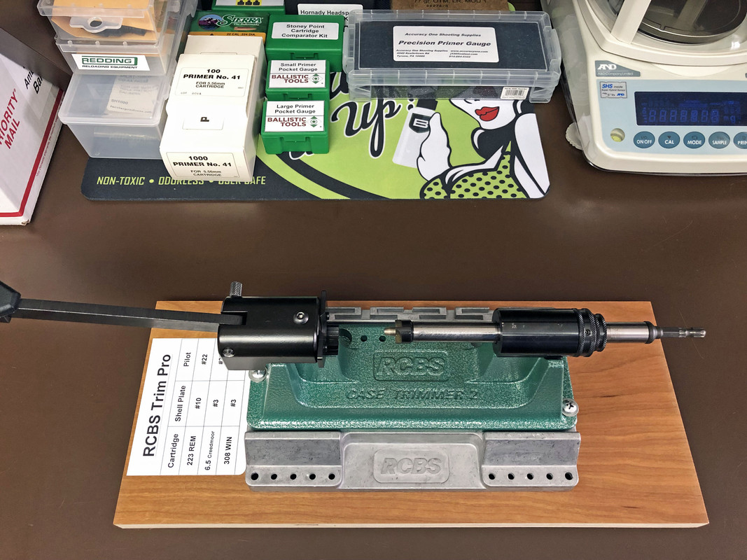

RickyK and Fire4Effect, as I reloaded for more rifles, I added more RCBS plates and trim cutters and motorized my RCBS trim cutter unit. Curious as to why you chose the Lyman motor instead of the RCBS motor? The only thing different between the RCBS Trim Pro when I bought it about 10 years ago and Trim Pro 2 is the universal shell holder that I can add for about $50. But I've got all the shell holder plates that I need without getting it. I like the fact that I don't have to change my cutter adjustments when changing calibers.

RickyK and Fire4Effect, as I reloaded for more rifles, I added more RCBS plates and trim cutters and motorized my RCBS trim cutter unit. Curious as to why you chose the Lyman motor instead of the RCBS motor? Was price a factor in using the Lyman motor rather than the RCBS motor? The only thing different between the RCBS Trim Pro when I bought it about 10 years ago and Trim Pro 2 is the universal shell holder that I can add for about $50. But I've got all the shell holder plates that I need without getting it. I like the fact that I don't have to change my adjustments when changing calibers.
Already had the Lyman. !!!
