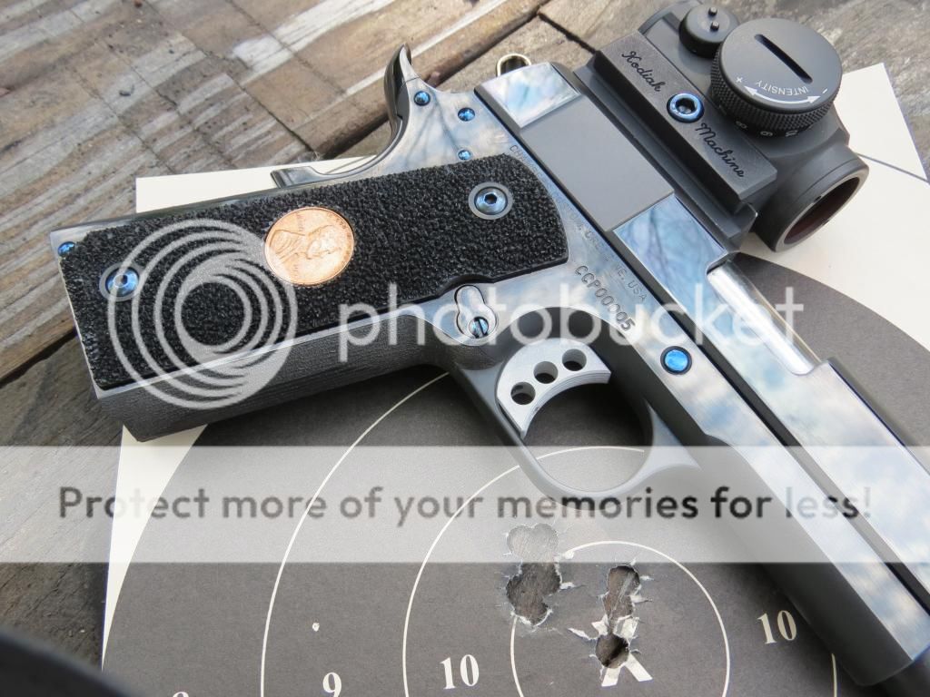

I built this gun for a gentleman who is not only a multiple time National Champion BE shooter but is also a dear friend. We call it "Moneypenny" for a certain personal reason and it sports a pair of un-circulated 1953 pennies in the grips.
With a touch of nitre blue and some tight groups this gun should go on to win many many matches in the future.
Enjoy the pics and thanks for looking!
1953 was a very special year...
I do like some stippling and Aztec cuts...good grip combined with nice cosmetics.
Four groups out of this gun with an average of 1.169" for 10 shots at 50 yards.
I love a polished blue finish...especially when it shoots this good.

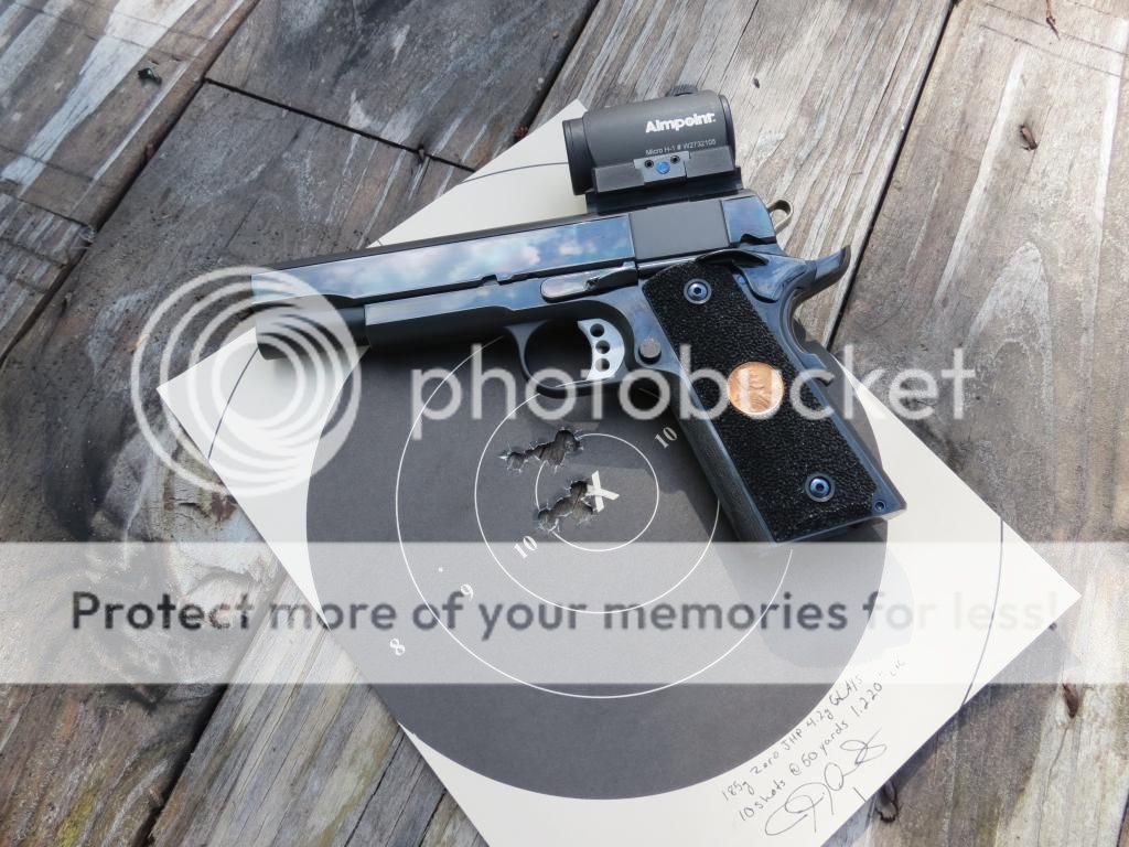

Two different 5 round groups...two different magazines...these are the things you can not learn shooting with your hands.
1.105" for 10 shots at 50 yards...almost broke the 1" mark again!

Joe C, I see double grouping. I suggest you experiment with seating depth. ;D
Very nice, great job as always!
Thanks all for the kind words. I'm glad you still enjoy seeing what I do here with "short arms".
precisionwelding01, the pennies are a sentimental thing to the owner...specifically the year. ;-)
Erik, interesting thing about that. It proves, once again, that changing mags can change POI. The REALLY interesting thing though is that the group still measures under 1.250" with the mag change! That means I did something right. LOL! (notice I finally spelled your name right! HAHAHA!)
