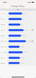

I have the latest and greatest best you can buy. Not sure what a modulating unit is but mine is variable speed on compressor and inside air handler. It has been over 100deg here for at least a month every day and here is my usage in a 4br 2500ft sq brick house with tall ceilings2B87A464-B9D8-404C-8361-330F55C46527.png
