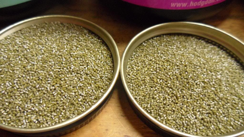

The black stuff was burned off - that yellowish green is the normal colour of smokeless powder. The black stuff is deterrent that slows the early stages of burning. I can't understand why it went out "(
So you are saying the deterrent was burnt off the surface of the extruded powder but the powder underneath did not burn?
Whenever I saw this it was weak hits from firing pin. Causes were from either primer nor seated deep enough, firing pin weak, firing pin light weight or too much heads pace. It was always CCI BR4 primers and it was because the cups are thicker and harder. The yellow powder was always the burnt stuff and it was caked back at the primer hole. Usually when this happened there was also hang fires or delayed ignition also. Matt
Thanks for the input. I will measure the firing pin Protrusion and see what it's at, I have fired about 250 rounds thru the action hopefully the firing spring has more life than that. I was not aware the actual powder is green/yellow color. I knew there was burn rate modifier coatings on it but assumed it was still black underneath. So thanks for the lessons. I appreciate the assistance.
I would think just the opposite. The yellow look the same as uburnt powder I get loading .38spl with win231 which is position sensitive becouse of the small charge in such a large case. I find it on the gun all the time..yellow at the bottom black or grey on top. Primer just didnt light it off like Larry said.
