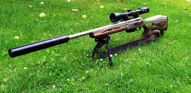

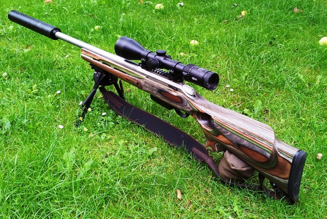

I have had the Meopta R2 2,5-15x56 RD for 6yrs. Very happy with it. The light control came loose after 20 rounds on the 9.3x62 Mauser, 2 weeks after I had it back again and with a new reticle (4K for 4c). Very good glass, good service if anything happens.
The 'missing' parallax adjustment is not a problem to 300m, 6.5x55 Swede:
Mine is a keeper :)
