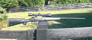

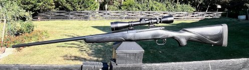

Selling a safe queen. Less than 70 rounds shot through it. Just never got around to using it. Time to go. Has a VX1 4-12 that just received back from Leupold. Cleaning and dial check. Like brand new.
Front action,lug and chamber length of barrel has been bedded.
RCBS dies. F/L and seater. LNIB
Have 88 pieces of brass.
Selling all $800.00 Plus shipping
Will sell gun & scope separately.
Shipping costs to be determined by zip code of course.IMG_4988.jpgIMG_4989.jpgIMG_4990.jpgIMG_4992.jpgIMG_4993.jpg
